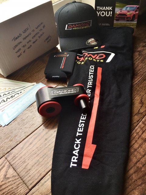

6F944A5E-5F93-4F8B-A512-9AE07DEAECEB.jpeg Wanted to give Damond Motorsports a huge shout out for what they are bringing to the Table for the Fiesta and Focus ST and working with me on development and testing of their new rear and passenger side motor mounts! They are coming over from the MazdaSpeed community where they have 9 out of the top 10 fastest mazdaspeed3 & 6 world record holders in the 1/4 running their mounts, and now they are coming to bring that knowledge and expertise to the Fiesta community as well! I’m more then excited to be working together with such a top notch company putting their products though there paces and prove why they are the best mounts on the market, though the rigorous beating & harshest conditions on track! Go check out the other awesome products they offer like there trans mount and catch cans + more and see for yourself why they are on my car!

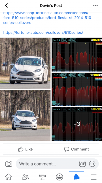

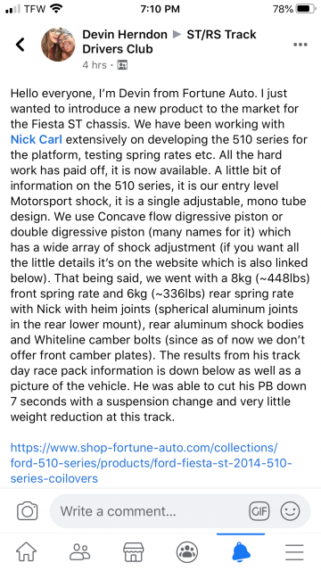

So a couple interesting updates as we are 8 HPDE’s in so far this season! As some of you may have found out from a previous thread, the 510’s have hit the market after we got very impressive data from them after trying a handfull of different spring rates, adjusting dampers and tire pressures as well. The time we picked up over the stock struts were unbelievable! 9445136B-86EB-4252-A57B-243FAE6F1B4D.png 540FDBF1-5BC4-45F1-9922-432A0C5911F9.png
https://shop-fortune-auto.com/colle...ucts/ford-fiesta-st-2014-510-series-coilovers
