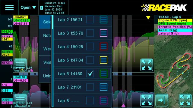

And some of the most recent updates that I would like to share is with the help of a JST 93 tune, I was .01, yes one one hundredth of a second off the official overall fwd track record at NYST. This was on 40+ heat cycled 595’s and my budget Ferodo 4003 pads. I will be going back on July 17th to hopefully take the record with the help of a set of sticker fz201s, going to a E30 JST tune, and doing some more taping of seams and closing holes for aero and drag! I also have reason to think I can get the fwd official track record at pineview run as well. 686EFBDB-F47A-44CA-A913-62D1A2701D6D.png DB42DC75-DE06-4407-8E24-C775CA4F1D20.jpeg E023E09E-7EAE-4B87-B211-C5354B8547C8.jpeg

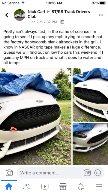

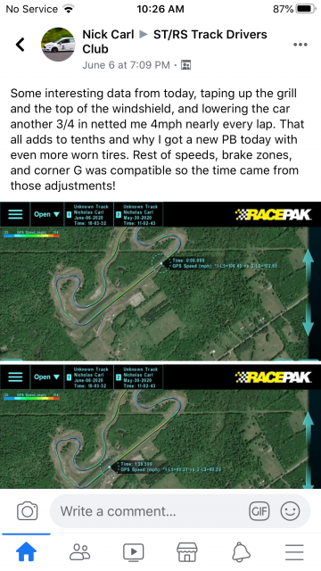

Some extra bonus info on what I learned from adding tape, and playing with Ride heights to Limit airflow under the car, along with a cool video on track from a unique perspective! The DA was actually double on the day I was faster as well! Yes you can say I have been very busy as of late lol
