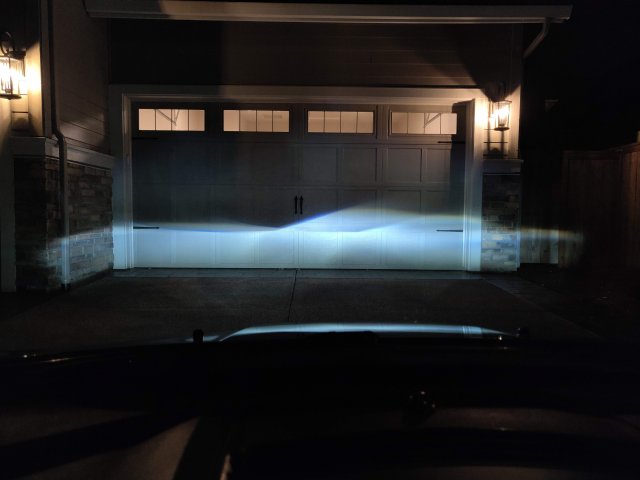

So you can see how the Euro in general go up at an angle so if we are "stuck" using the Euro/ECE cutoff, we want the upward part to go to the right so we don't blind oncoming traffic coming at us from the left. In the real world, it looks something like this:
So a little aiming might be required and HID or LED will look better than that color as well, but just a little pic to see... If you don't want that kind of cutoff, then you have to upgrade the projectors, which is much easier than a full retrofit of a reflector housing, and when using aftermarket headlights, they are much easier to split than OEM too. I've had a chance to chat with some people who have done this exact thing on a FiST, upgraded these Depo headlights to better projectors but that would be about $275 for the projector kit and HID kit and I'm just not interested in spending that much right now. Unfortunately, the one person I have chatted with directly on this didn't even bother trying the projectors they came with first, UGH, would have been nice to see a before and after! Anyway, it may be a project down the road for me where I paint the interior black as well.

Justa quick update, the new Depo Euro projectors are amazing quality! They came close to aimed perfectly and have tons of vertical adjustment available with the one screw on each side. Only issue is that they, unlike Depo's of the past, do have the same wiring as OEM and TYC, so you do have to do a pin swap to get the LED strip to work. Also, since they are "halogen projectors" (blah, clash of good and bad there), LED's designed with halogen filament placement in mind work really well, HID's with the long bulb and capsule too far forward in the the projector do not.. but they also are FAR easier to upgrade the projector on with the butyl sealant that can be oven warmed and split with a Morimoto 4LR-R upgraded in easily, but with Katana H7 LED's I'm loving the clean output!
