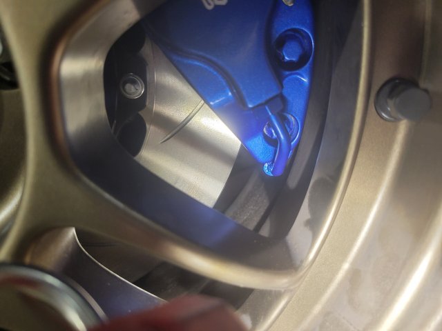

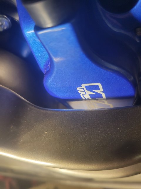

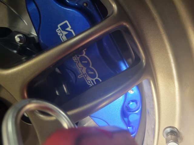

I bought H&R +10mm spacers and extended lugs. Installed the lugs but it looks like I can run the wheels without the spacers. Took some pictures but does this look/sound right? It would normally hit the face of the caliper on the spokes or the outside edge of the caliper on the barrel? Neither hit.

I have the Porsche Carbon Ceramics on the GT4 and they have more clearance than you're showing. It's typical to get rocks/pebbles trapped between the caliper and barrel, resulting in scratches around the barrel of the wheel.
I can't say for sure it's not enough clearance based on the pics or that you'd have severe problems, but that would make me concerned based on my experiences with the slightly more clearance that I have.
It could also be the perspective in the photo. But man, the caliper/barrel gap seems nonexistent.
