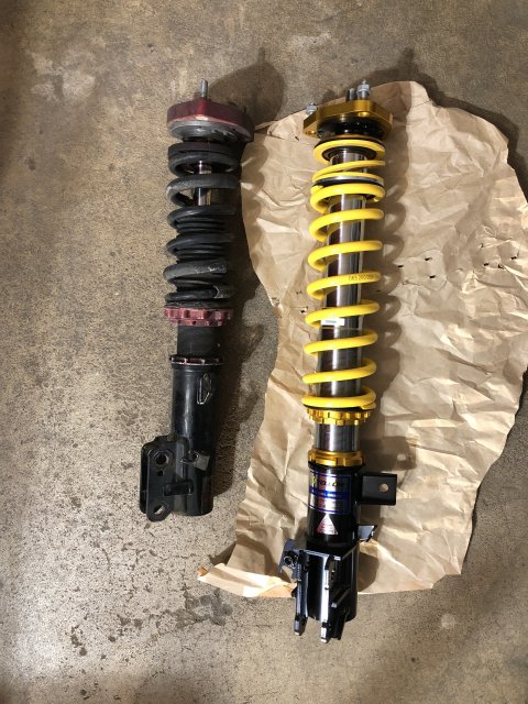

Upon receiving and unboxing them, I'm impressed with the build quality and beefiness. Each front strut feels like it weighs in around 25 lbs.

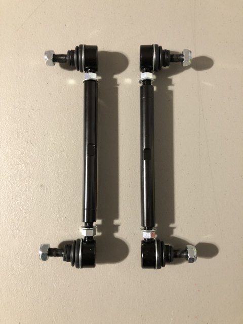

The new coilovers also came with new sway bar end links but I just reused my Whiteline end links

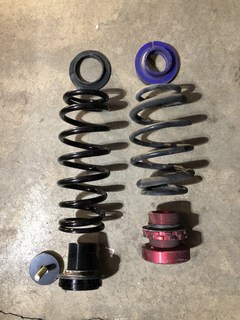

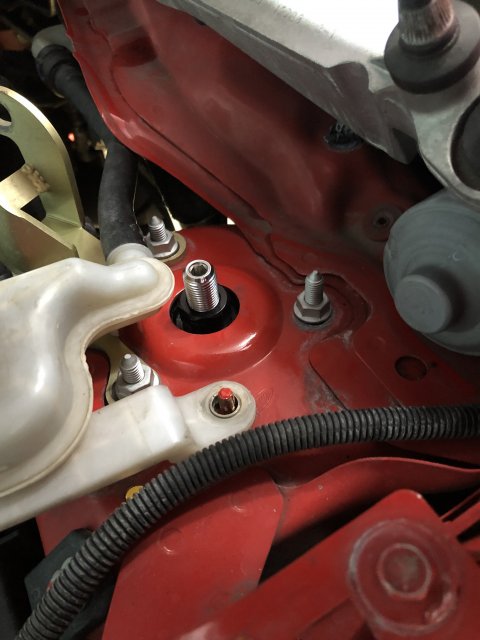

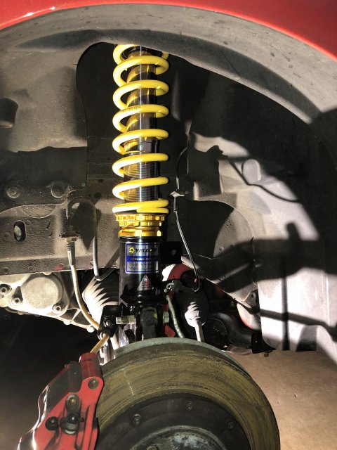

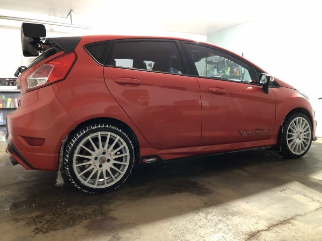

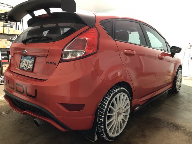

Some pics from the install. No major issues but I did have to adjust the fronts to the lowest height setting to get them installed initially. I also removed my Eibach rear sway bar because the bolt heads interfered with the rear shock mount because it's larger diameter than the MeisterR.
I'm almost at the lowest height setting and I've got about 2.5" of wheel gap right now. I was hoping for around 2" but it might settle a bit over time. I still need to find a good damper setting but I'm starting with the standard settings for now.

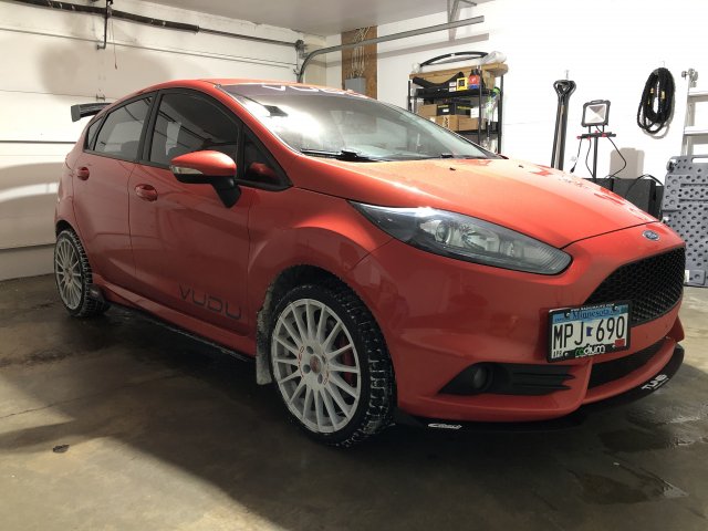

Did you get the very LAST set of white Superturismo GTs/WRCs in the country?!
(What tires are on them?)
The R5 wing (is that the actual one Ron had up for sale?) and R5 style turndown are really cool, but Mk7 Fiesta rally cars do not use side skirts/splitters, nor that type of front splitter, as they use those flexible air dam style things in the front.
Is that about as low as those Yellows could possibly be set and still function properly?
You stated "almost at the lowest height setting", but, is there even a 1/4" of lowering left in the adjustment?
I ordered the wheels from driftshop.com. I'm running Blizzak snow tires. I'm planning to buy another set of 17s for summer, maybe another set of the WRCs but I'm considering other options. I already have some new Michelin 4S tires on hand for summer.
Indeed this is the R5 wing Ron had for sale. This won't be a true R2 or R5 build, but it has definitely inspired the choices I'm making with the car right now. Just trying a new direction, mainly just for fun. I don't plan to compete but I have been looking at some local Rallycross events so who knows! Also, we have ice racing here on the lakes so that could be fun too! http://www.iceracemn.com/
A couple more items planned for the build is an AP Racing BBK and SS-Tuning fender flares.
There's about 5/8" of lowering left in the front struts but I could not get the rears to go any lower. I wanted the car to sit as evenly and level as possible so I did bring the fronts up to match the rears.
