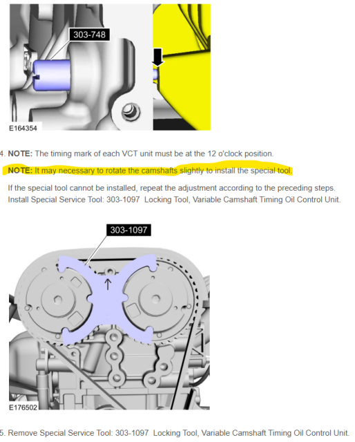

Id try to insert the timing pin, flywheel lock and the cam bar tool to see if its all in time prior to yanking the belt and TTY bolts. Document that it is off prior to having JST retime the motor so there is no pushback.

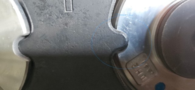

As I suspected the timing is off. The logs from this morning on cold start showed VCT-I Angle pinning at -41 sometimes. It was definitely off. They’re putting it back together and I’ll pick it up next week.

That’s what we did.

It was a bad tensioner from Ford. Replaced it and alls good.
