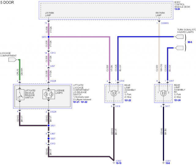

Just noticed this morning that when the passenger side DRL stops working my passenger side running light for the tail light also goes out

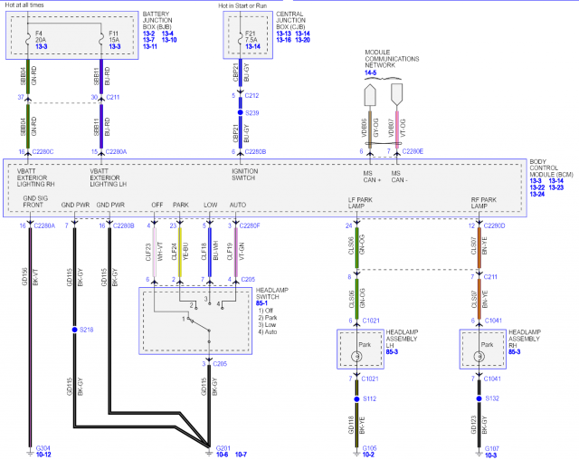

I would unplug both lamp assemblies then back-probe with a volt meter at the BCM (Brown/Yellow and White/Orange) to see whether there is any output.

I assume the license plate light is out also?
sorry for the super late reply didn't realize i got logged out so wasn't getting any notifications. no the license plate light doesn't go out when the passenger DRL and passenger taillight DRL both go out simultaneously.
i assume i should be seeing 12 volts at both wires out of the BCM, and i would do this test with the headlights on just not plugged in?
I have fixed the issue, I swapped my wire from the high position in the connector to the low position and no more issues been running flawless for about 2 weeks now, I might run another wire for highs when the parking lights are on, thanks for your help. @Intuit

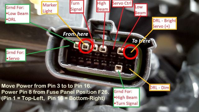

My Euro lights do not have the parking/marker lights. (which is against code here in the US) So the wire that is ordinarily in that spot, is moved to another, to power the DRL on dimmed mode. (ignore the 'from' and 'to' in the image - use lower left instructions instead)
F26 BTW may occasionally keep the DRL on bright for up to twenty minutes with the engine off. The logic for keeping F26 active after ignition off is unknown to us, but might have something to with engine temperature.
In any event, the DRL are low wattage; that wattage is listed on the back of the housing. IIRC (could be wrong) each one is only 10 Watt which is about 2 Amps combined at 12v for both lights.
There are many circuits that are only active when the ignition is running. Adding a relay to that circuit to power the DRLs is an alternative to F26.
Avoid the temptation to power the DRLs directly (without an add-on relay) unless that circuit is unused and was engineered to support the Amps needed by the DRLs.
