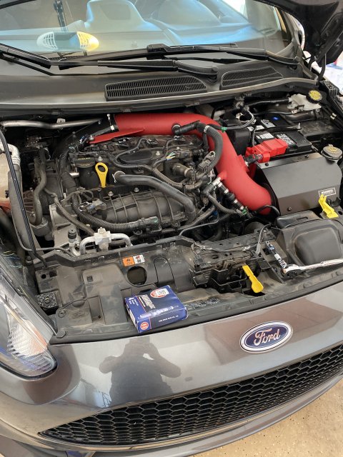

Anyone done it on 16+ fist? Is it worth it?
If you want to run any of the good intakes, yes. The adapters dont usually work (except the mountune one). But if you want something like 2J or ITG you need to convert. It takes maybe 15 min to change.

I have a mishimoto intake for my 19 and so far with their adaptors for the 16+ years it’s worked great. No issues here. 🤷🏻‍♂️

D2BZ-9C047-E (Description says Fuel feed line or something like that but it's what you are looking for)
