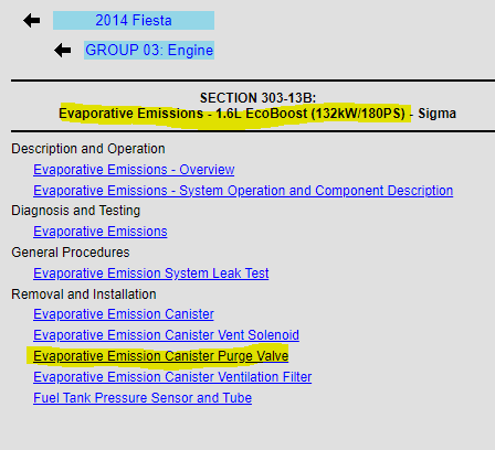

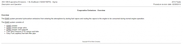

Ask them then why it's listed as evaporative emission in the workshop manual! It's always a battle with those stealership smh.
