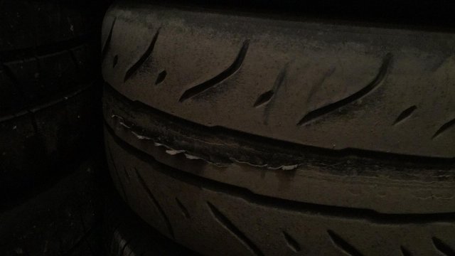

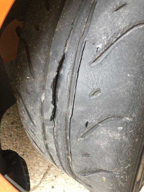

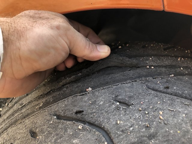

This is happening A LOT, especially in the Solo-Spec Coupe community for FRS/BRZ (this is the spec tire for that class).
Consensus seems to be that, if you dont do a few heat cycles/scrub in before competing on these tires, the center tread will pull away pretty easily from the tire.
Haven't seen any responses from Tire Rack or Falken yet.

Falken never responded to my email. Tirerack said perfectly normal and not to worry pretty much. Here they are after 3 events and 26 or so runs or 26 minutes of runs...... 6FE4794C-D493-4EB3-8C5F-37B508A5EF9D.jpeg 0E48C556-BA0D-4B14-B9BE-176E003D5C26.jpeg

Damn. They’re roached. That’s too bad. I was hopeful they’d give us at least 1/2 season since our cars are lightweight. Looks like they’re good for competition only.
