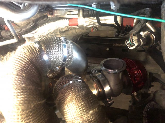

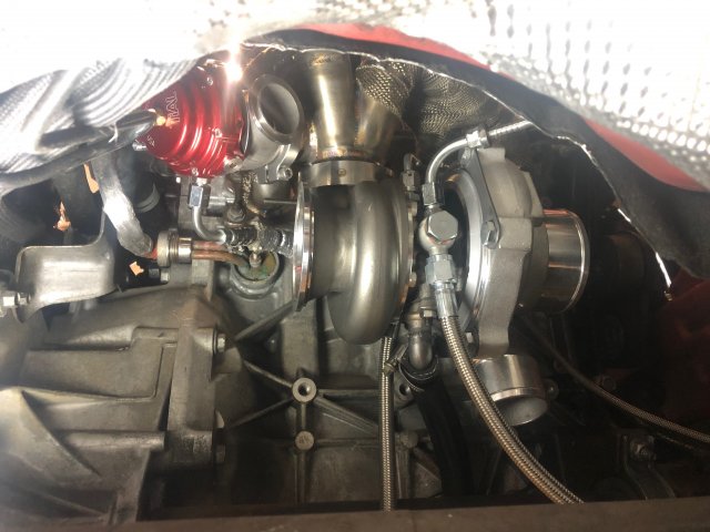

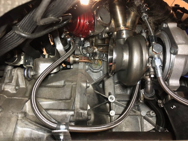

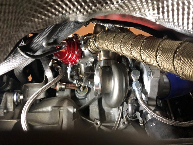

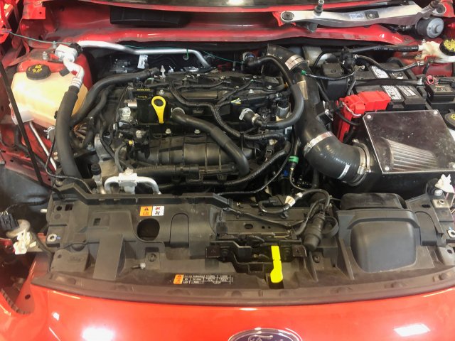

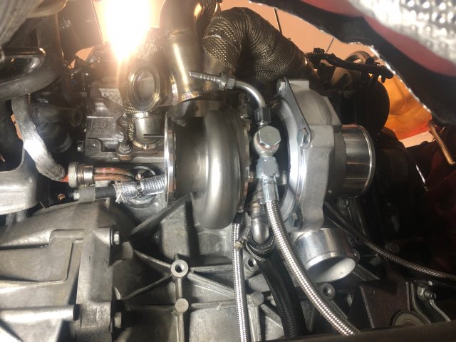

Thread Starter #29
So we did all the necessary modifications to convert this to a .52 AR ratio with EWG.
Build thread will be up soon. Here are pics in the meantime. @koozy was a huge help with this.
Car is FUCKING LOUD now :p
