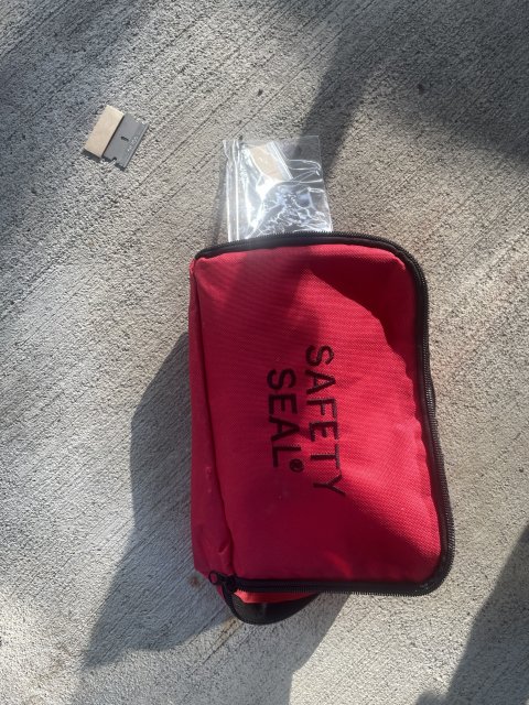

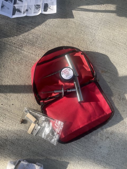

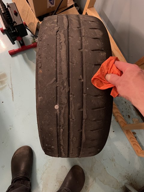

Nothing is more irritating than a screw in your tire. I’m just glad that these tires are almost at the wear bars. While I wait for new tires, I figure it’s as good a time as any to try my own hand at plugging a tire. Doesn’t seem that hard when the shops do it.
For about $50you can get one of the high quality kits popular with the overland crowd. ARB and SafetySeal seem to be two of the favorites. I opted for the latter.
First, the kit smells to high heaven like raw rubber/new car smell/air freshener. Past that, it turns out it’s ridiculously easy and quick to probe and then stick the plug in and you’re done. Still holding pressure, so I count that as a success. I wouldn’t do a track day on one (need a good internal patch from a shop that knows what they are doing for that) but it is just fine to extend the life of a tire on the street. The extra miles to wear off the track rubber I picked up also helps!
9/10 would recommend (except the smell - keep it in bags)

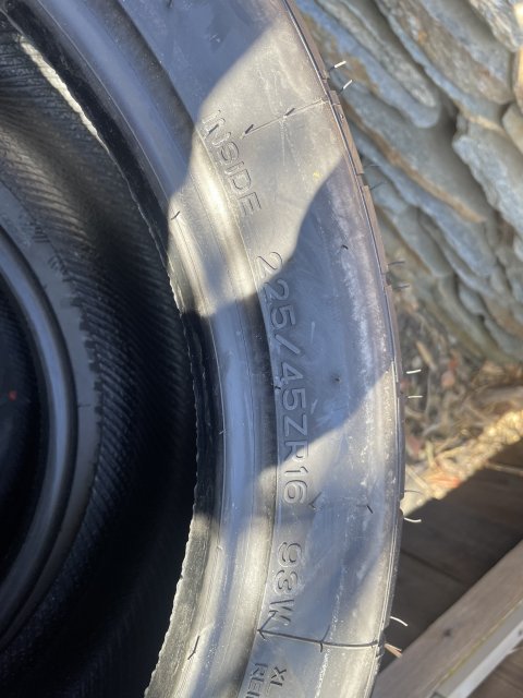

Speaking of tires, the Tire Rack fairy had a new size offering as of this spring, and a set appeared on my doorstep! I’m excited to try these out. Crossing my fingers that they don’t rub. Anyone want to guess the tire?
14,949
7,388

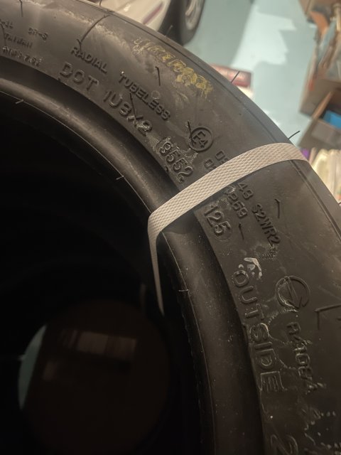

Nankang CR-S
I have a brand new (but old build date) set of A052s in that size with the stickers still on them that I want to sell, CHEAP.

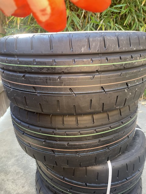

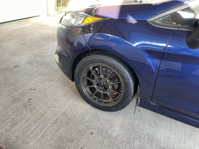

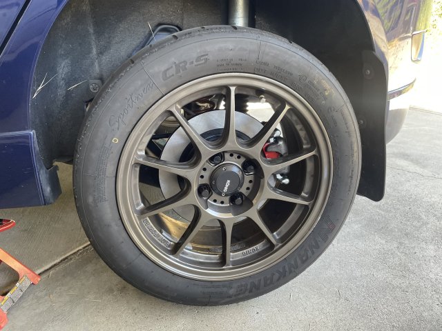

Nankang CRS 225/45R16 in the flesh! Jan ‘25 date stamp, finally wore out the RE-71’s and got them mounted.
Had them on for a day or two so far and I’m really impressed. Compared to the two tires I ran previously (RE-71RS and Rival S 1.5) They’ve got a lot of the best aspects of both wrapped into one. I was worried about tire clearance to the struts, but it seems they only sit 3-4mm closer in than the 215 RE71’s and there’s still enough clearance that the casting boogers are still clear of the struts
They feel nice and grippy, with good ride quality and responsiveness like the Bridgestones, but at the same time they have stiffer sidewalls and snappy steering feedback and don’t fall off at high slip angles, more like the BFG’s. I’m looking forward to getting them out on the track in July!

Given the 40ET of the dekagrams, do they poke very far out of the fender wells?
That was the other concern I had about mounting that same size A052s on my Dekagrams, even at factory ride height (besides the inner suspension and liner/mounting hardware issues).
Surprisingly not. They are again slightly wider than the 215 Bridgestones , but not ridiculously so.

Man, that's a meaty fitment. Did you weigh them? Curious about the weight of 225 16s tires.
I did not weigh them, but putting them on they felt slightly heavier. Tire rack specs say 22lbs for the 225 CRS vs 20lbs for the 215 RE-71RS.
Either the RE-71 runs wide mounted on an 8” rim or the CRS runs narrow because I was worried about contacting the strut since the Bridgestones had only about 8mm clearance to the strut.
Now that I think about it, it makes sense that section width is being affected by rim width since the “measured rim width” for the 215 is 7” and the 225 is 7.5”. The wider 8” rim will pooch out the sidewall farther.
Its possible that’s the origin of the hard to verify claims that “X tire runs wide”, because they’re almost always being mounted on a wider rim than the “measured” rim width.
What that also probably means is that going up 10mm in section width probably doesn’t actually mean a 10mm wider tire when mounted on the same rim.

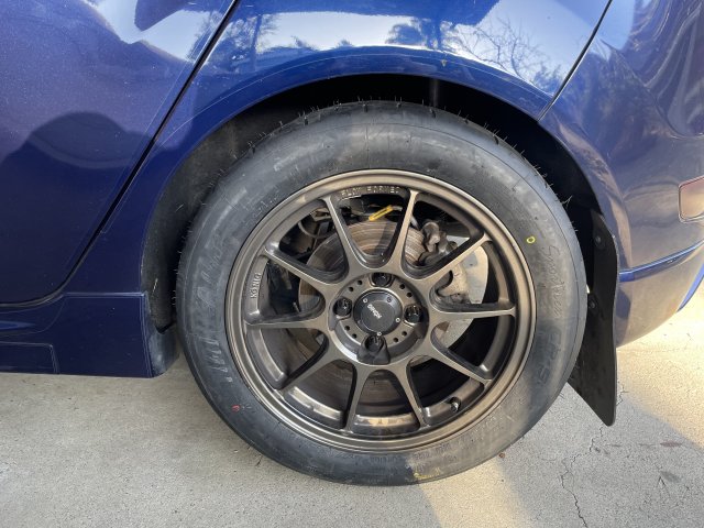

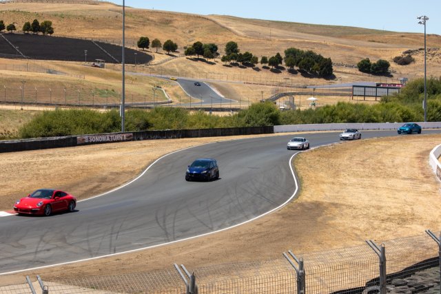

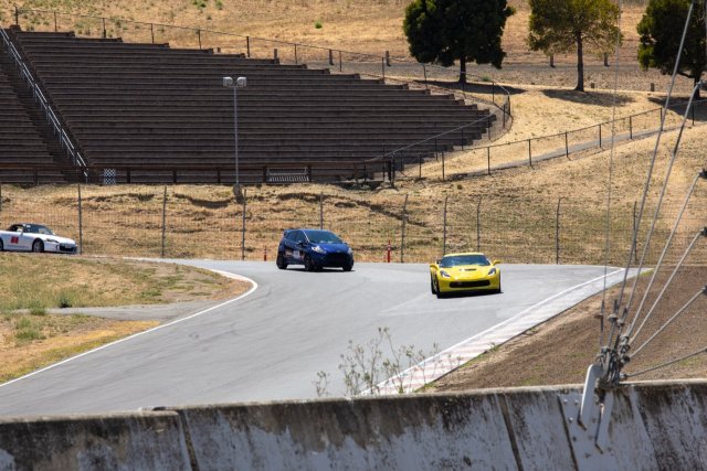

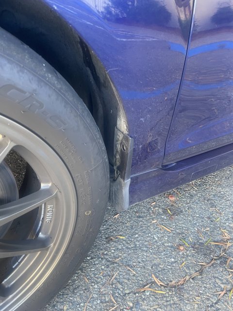

Another track day at Sonoma!
All in all went really well. I did discover that the 225/45R16’s were rubbing on the track, and it turned out to be interfering with the rubber washers on the front rallyarmor mud flaps. Faced with the philosophical question of “wide sticky tires vs mud flap style” I had to choose tires. So the front flaps were hastily removed at the track and the rubbing went away. Still on the fence regarding the rears.
All in all a great day at the track, and I also got a chance to test my latest modification, hinted at above. Stay tuned for something cool!

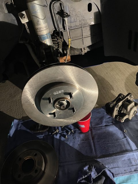

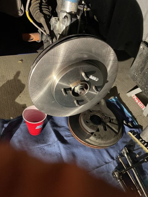

SVT Front Rotors:

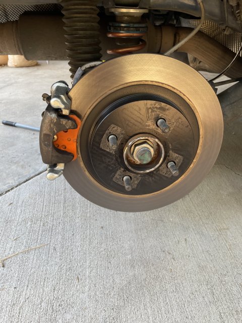

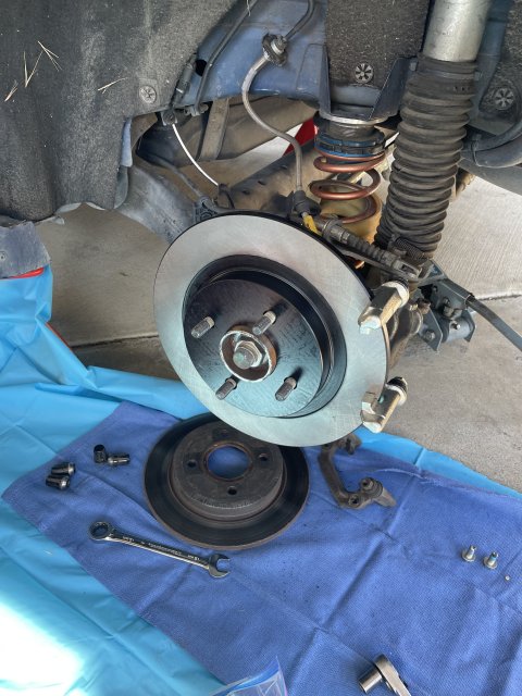

Step one of course was installing the fairly standard upgrade in the rear with SVT 280x9mm rotors using a bracket kit I ordered a while back from Pumaspeed.

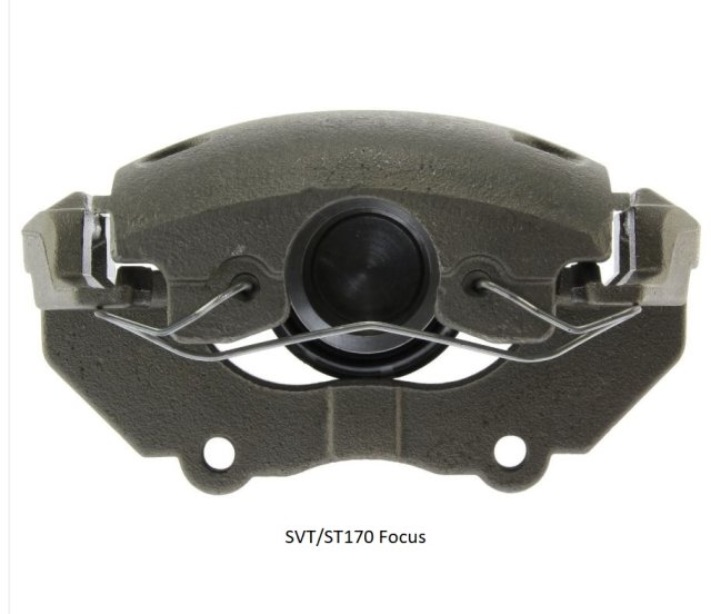

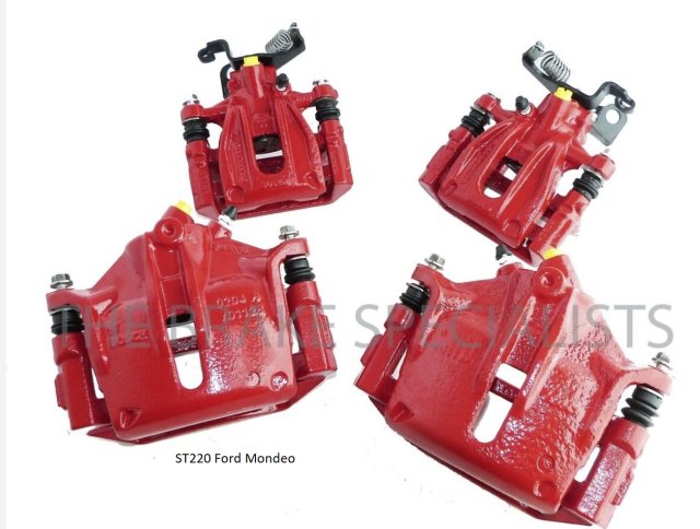

The biggest problem is that between the Mk6/7 FiST in the UK and the Mk7.5 that finally came to the US, the caliper bolt spacing changed from 90mm ATE caliper that’s ubiquitous among Ford vehicles to a unique new 120mm TRW caliper, so the easy options are no go for front calipers, Specifically, SVT Focus, Focus ST, and also the bolt-on Mondeo ST220 swap that people have done in the UK to older Mk7 FiST models. Ironically the Mk8 FiST went back to ATE, but oddly retains the 120mm spacing.
SVT Focus:
Model ST220:

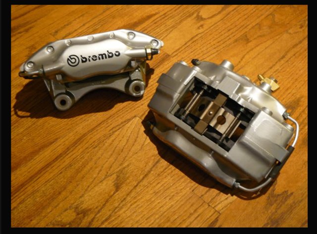

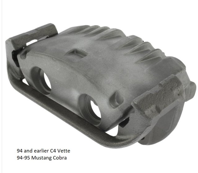

For the Mk1 Focus 324mm option, it turns out a decent match would be a C4 vette/Mustang Cobra 2-piston caliper made by PBR. This is also the caliper that Baer uses for their classic car kits. Some years (94-95) Cobra had 38mm pistons as did 94 and earlier C4 Corvettes (base model, not Z51), a good match for the stock 54mm single piston. Because of the low spoke profile of the 2-pots, these would potentially be an option for stock 17” ST wheels, I just didn’t pursue it.
PBR 2-Pot Caliper:
As much as I would love to go with the bigger 324mm option, measurements revealed just the rotor simply wouldn’t fit with the 16” Dekagrams no matter what caliper I used, at least if I wanted balanced wheels with weights. A 316-318mm might fit, but there just aren’t clean options.
Also, it seems the original unobtanium
Mk1 RS Brembo calipers (the silver Brembos pictured below) used a less common small 2x36mm piston diameter shared with the ‘00 Mustang Cobra R which is otherwise not found much outside of aftermarket Brembo and Stoptech brake kits. to maintain brake bias with the 280mm rear brakes carried over from the SVT/ST170. Not the end of the world, but again, front biased brake setups underutilize the rear brakes, additionally compounding the front rotor heat problem we’re trying to solve here.
Mk1 Focus RS Brembo:
That leaves the 300mm SVT Focus rotors as still the most viable option. The stock rotors are about 11.5lbs, with about 6lb of that in the hub. The SVT rotors use the same hub design are roughly 2lb heavier, but 100% of that is where it counts, increased vane area (almost 65mm of swept pad height)
Unfortunately 120mm caliper bolt spacing on the FiST is uncommon. The few closest matches I found were R53/R56 Mini Cooper (which uses a very similar TRW caliper) and the various generations of Miata. E46 BMWs used 122mm which is kinda close-ish if you squint.
ND Miata Brembos use an even smaller 34mm piston and the JCW mini uses 38mm pistons, but both are either new enough or uncommon enough to be obscenely expensive even used.
Sadly because of their original mounting hole locations, none of the above options are anything close to a direct bolt-on and even the mini JCW and E46 mounting holes are positioned farther out such that it would align to a smaller rotor than even the stock one (despite the fact that the 330i used larger than 300mm rotors). I even ordered and then returned some calipers and brackets just to make sure
A couple of stock photos from the Internet of some of the calipers (thanks Rockauto) below.

I 86ed my mud flaps about 2.5 years ago due to rubbing on the front Rally Armor mounting nuts by even just 205/50 Neo Gens on Dekagrams on factory ride height/suspension.
Given that working on any ARA rallies (ALL gravel) is an impossibility for the foreseeable future, as there are none within even 12 hours driving time of my locale currently, I really do not need them, save for 'the look/style' as you've stated.
That, plus most to all of the Rally1 and Rally 2 WRC cars at least do not even use mud flaps on tarmac events anymore, even if the rally has gritty/muddy 'cuts' on the corner's racing line/apex.
So they stay off of the car for now.

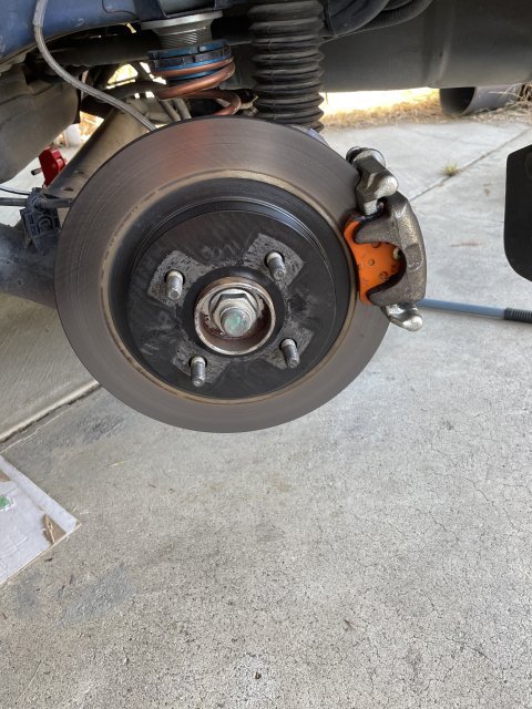

Brakes Part 3/5:

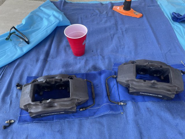

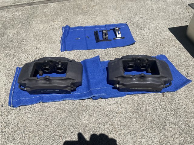

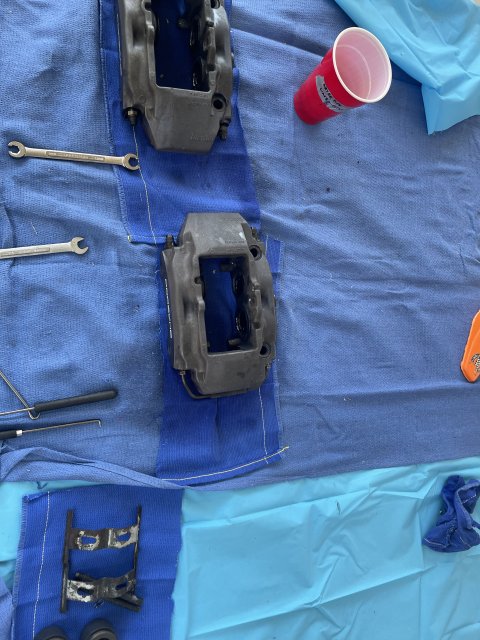

It became readily apparent that there would be no bolt-on caliper that would work without some fabrication.
As it turns out, what I finally found is that calipers from the base model (non-S) 986 Porsche Boxster (with 2.5/2.7L engine) turned out to be a almost perfect match for the rotor size. Designed for 298x24mm factory rotors. 36/40mm four pot radial Brembo calipers. An exact match for the stock FiST 3.55 in^2 front caliper piston area.
OEM grade Brembo calipers, massive choices in pad selection, because Porsche. Sub $200 pad sets in 737 pad shape and $50-100 shelf stock rotors. What’s not to like?

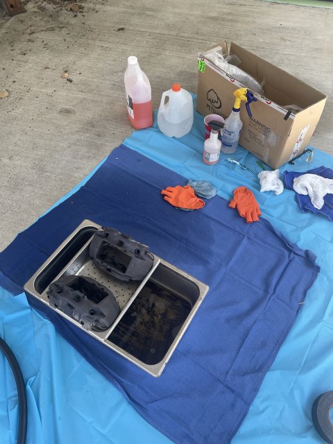

Post-cleaning:
The Porsche calipers are radial mounted, so that does mean a custom bracket is in order.

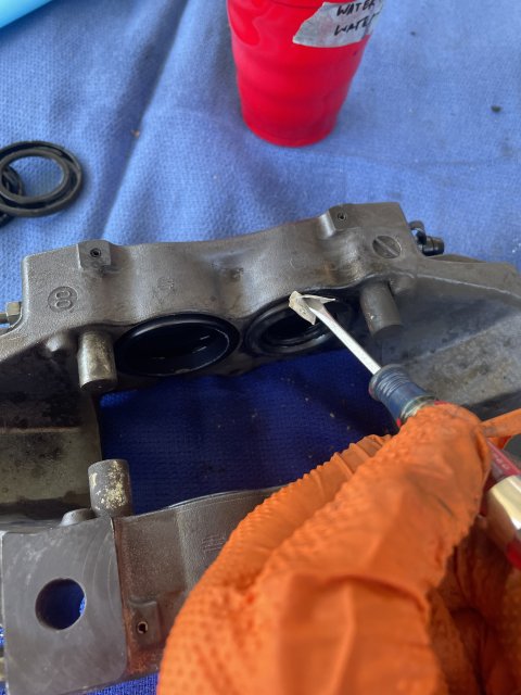

I picked up a used set of Porsche calipers for $300 off eBay. A rebuild kit (seals and dust boots) can be had for under $100. Rotors are available as cheap as $30-60 off Rockauto.

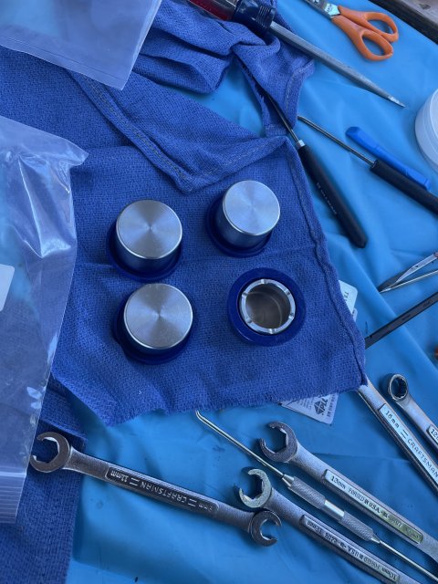

Pistons removed:

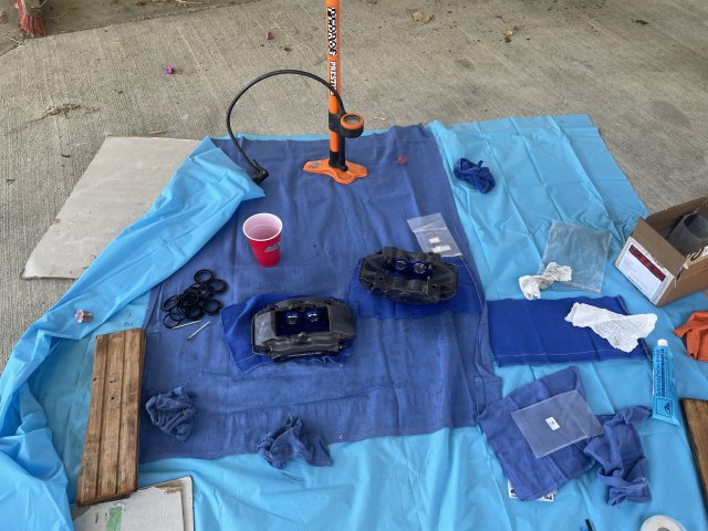

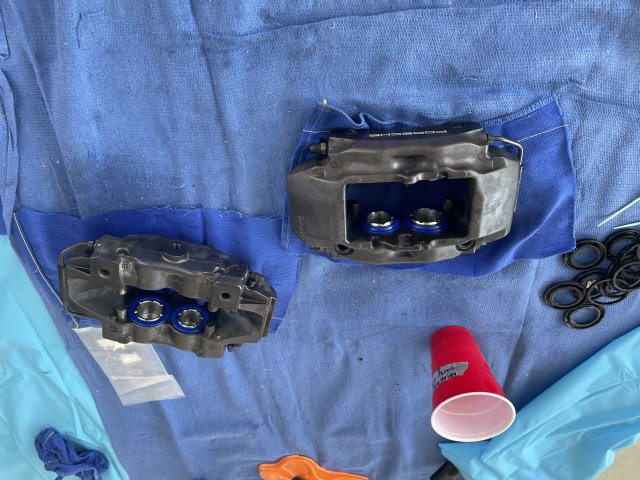

One really important point during the rebuild process is that because the Fiesta calipers are in front of the axle in a FWD configuration vs the Boxster calipers aft of the axle in a typical RWD arrangement, that means the calipers need to be inverted to keep the small piston on the leading end, but that’s a simple matter of swapping the bleeders and the bridge tube. It sticks out instead of being tucked in a notch, but it’s also now on the trailing end of the caliper and less likely to get damaged anyway

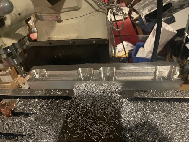

So about $500 in at this point (not counting pads) plus some bolts. Fortunately I have access to a machine shop and some billet, so I set about designing some brackets.

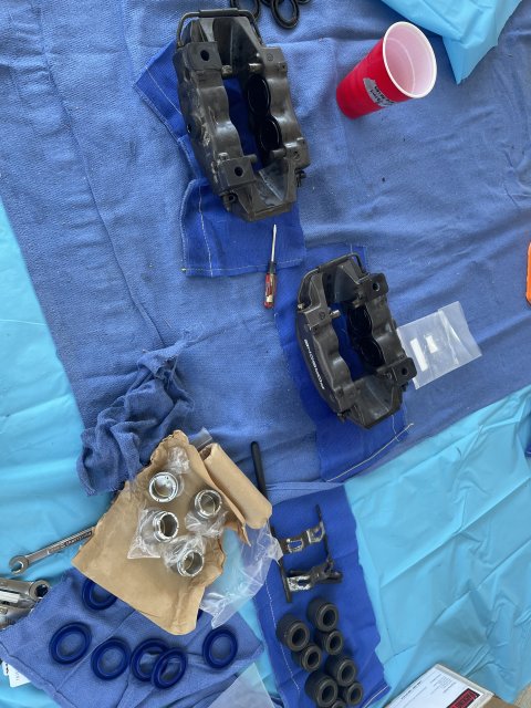

Also I blew up the budget a bit spending an extra $300 on a Racing Brake stainless piston kit with high temp dust boots, and opting for the $100 each Cryo treated Centric rotors from Tire Rack. Oops.
Racing Brake piston and seal kit:
Reassembled with ATE caliper assembly lube and bridge tubes on large piston side:
