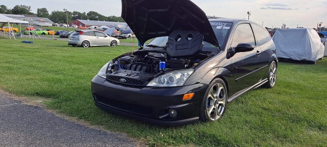

It sounds like your about at the limit of the coil packs as well πŸ˜… stay tuned πŸ€™ if your interested in getting a set of these coils for testing shoot me a message. The new coil hold downs hopefully will be done the beginning of next week and then its on to more testing! 😩 the waiting is killing me! πŸ˜… Since my fiesta is somewhat down atm because the entire coil pack setup is off the car ive been playing with my ecoboost swapped svt focus. Always something to do! D2E10285-D6A5-413C-A17D-4DEE41F3D7AA.jpeg

It sounds like your about at the limit of the coil packs as well πŸ˜… stay tuned πŸ€™ if your interested in getting a set of these coils for testing shoot me a message. The new coil hold downs hopefully will be done the beginning of next week and then its on to more testing! 😩 the waiting is killing me! πŸ˜… Since my fiesta is somewhat down atm because the entire coil pack setup is off the car ive been playing with my ecoboost swapped svt focus. Always something to do! View attachment 49906
That. Is. Awesome! EB 2.0? I love the SVT. When the time is right I'd love to find a non-salt-belt example, clean it up, and just stare at it.
Ecoboost swapped SVTF? I want to hear more about this!

Ya its a 2l ecoboost swap! 78k on the body Its fairly straight forward to do the swap this one was the first svt with a eb swap. Theres i believe 2 svts swapped now not counting jeff bosse’s sedan but ive had it for a few years now and daily drive it πŸ˜… 2l eb stock turbo fbo with a balance shaft and vaccum pump delete also on e30 and self tuned via hptuners. Car has a duratec 5 speed trans a control pack ecu from james mcbrine in the uk that works perfectly! And the factory ecu is piggy backed with the control pack ecu so the factory cluster and everything works. The 2.3 will bolt in and you can use a rs trans and rear subframe to make one awd. Im actually considering getting a rs trans and rear subframe to make mine awd just need to find a wrecked rs for a good price. Heres a little better engine bay picture. This car looks like it came factory with the ecoboost in it so at shows like ford nationals it doesnt get much attention because it looks stock but if you know you know πŸ˜… this year at fr2022 i had to put a ecoboost engine cover sitting up so people would actually realize it has a engine swap πŸ˜‚
