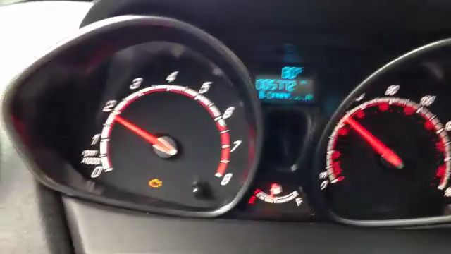

Nice man - how would you describe the sound?! I'm considering this but don't want it too loud. Thanks.
Stock with rumbling on decompression. Opens up in higher rpm. I removed my symposer and it sounds near the same as with it connected if I had to say anything.
Resonator delete soon.
Not loud at all.
Btw- it stinks like a mofo lol
