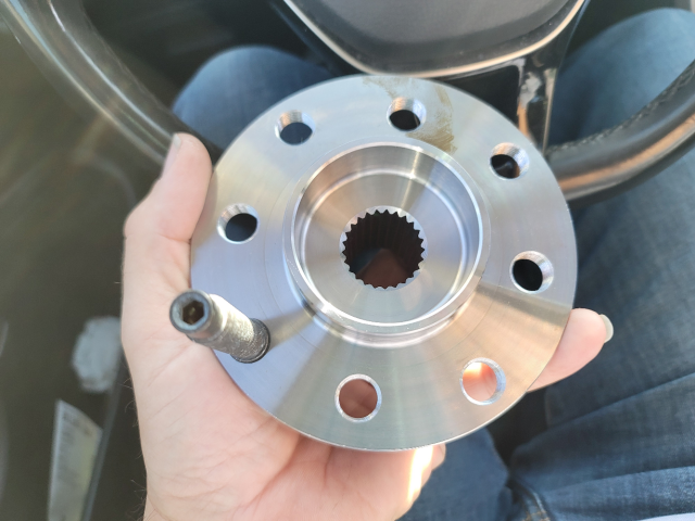

There are no acceptable 15x9 in 4x108, at least as far as I can tell. I have a pair of Advanti 15x9 in 4x100 that I am planning on using once my drill template is received. I dont mind using hubcentric wheel spacers either, so I figure too shallow is easier to correct (with spacers) than machining a too deep rim.
Anyone know a good place to get a 4x100 drill template? I have ordered on from "Alexthemachinist" but there is no response from them as to when it will be ready. Ordered a month ago.

-We are swapping the front wheels to be able to use 4x100 so we can run 15x9 wheels there. We had Justin at Aero Mach Precision in Mesa, machine some custom hube that have both 4x100 and 4x108 threaded holes in them so we can run 4x100 at track and just reposition the studs to put 4x108 wheels back on for the ride home, and so we dont waste all the wheels we currently own. We machined in m14x1.25 threads in the hubs, and got m14x1.25 to m12x1.5 reduction studs. We wanted to reuse the existing stud holes at 4x108 and have larger threads for strength, instead of using straight m12 studs. We got the studs from motorsporthardware.com, I think they are for a mini or something.

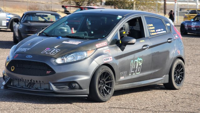

The first TT of the season has gone really well. The car is much better, and puts power down really well with the plate diff. In fact, I would say it's one of the best things we have ever done to the car. The car seemed to work well, we had it run by 3 different drivers over the weekend and everyone went fast.
The event was at Wild Horse Pass East course. We pulled out 2 first place finishes, just beating a really well sorted 10th gen civic and a well driven first gen BRZ by around .1s each day, and there were 8 total cars as well. Our best time of the weekend was a 1:04.2, (down from a 1:07.8 the only other time we were here) which is only around .6s from lap record. Our second driver, 13yo kid, was able to lay down a proper 1:05.5 by the end of the weekend as well. We were also up around 4mph from the previous time at the track, mostly due to some more power from the Stratified tune.
We were able to fit the 15x9 35et Advanti Racing wheels up front with the new 4x100 bolt pattern. They barely clear the brake caliper and scrape the wheel a bit when anything bigger than dust gets between the rim and caliper, but it worked with no rub on fender or strut with the 15mm spacers and 245/40/15 tires. With the 15x8 and 205 rear the car was pretty balanced.
Up next is to try a bit higher front spring rate, as the car seemed to roll more than we thought was good for it, and to look for ways t get more power. The rules this year should let us run around 230 whp, so we need to find like 40..... Looks like hybrid time soon.

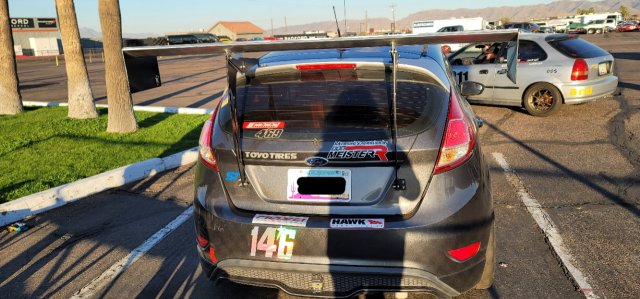

Didn't run a wing, it hasn't seemed to help in any meaningful way. We have yet to be able to make the car loose enough to warrant the wing.... May have wasted a bit of money on that... There is a fast track around here that is where i was convinced we needed it, but have yet to go back. Slower corners the car doesn't need more rear grip, over like 80 it may want it then.

I am also guessing that our factory ST rear wing does very little as far as rear grip goes, at any speed, and that's why you have no ill effects from running just that smaller, base Fiesta wing, which is installed since it is the only way your aftermarket TT/TA type wing will fit on the car, correct? (Or do you have the M-Sport R5 wing, I forgot [dunno]).

I cannot feel any difference between the 2 wings. I am sure there is a small benefit with the ST wing, but if anything I want less rear downforce, and if there is a need for some I want lots... So for the typical less than 70mph corners rear lift or no rear downforce is fine, if not preferrable. For the 80+ corners I want lots of downforce because the repercussions are scary. So fast tracks Ill run base wing with 9-lives racing wing, and slow tracks Ill run just base wing. Plus it is slightly lighter...., and we just leave the brackets in it either way so its fast and easy....
We are actually running experiments right now sealing up the holes on the factory wing. So far it’s been pretty positive feel wise . Danny did a number of streamer tape tests to see how air was flowing both sealed and unsealed to see the effect if any it was having. I have noticed better gas mileage with them sealed up.

We also tried taping up the ST spoiler holes at the fast course where the car was trying to kill me, and it did not make any difference on data for top speed, or cornering speed. At least nothing outside of noise. I am sure it makes a difference of + or - 10-20lb at over 80mph (at least I think that is within reasonable expectations) but I dont think I could feel 10-20 lb placed in the trunk either, so....
