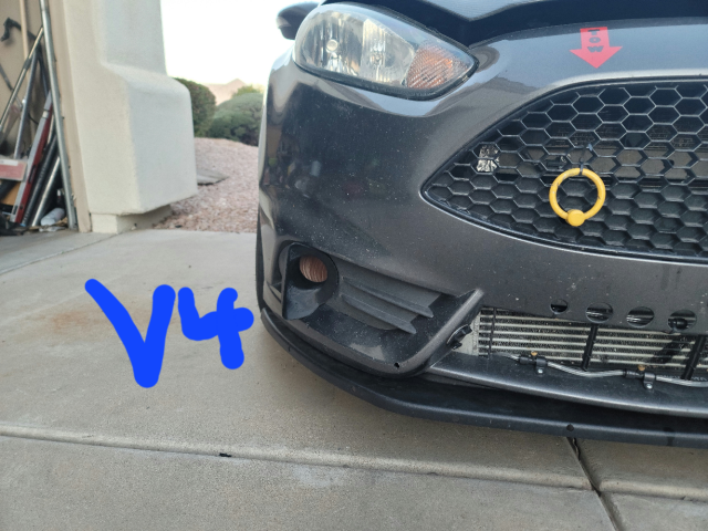

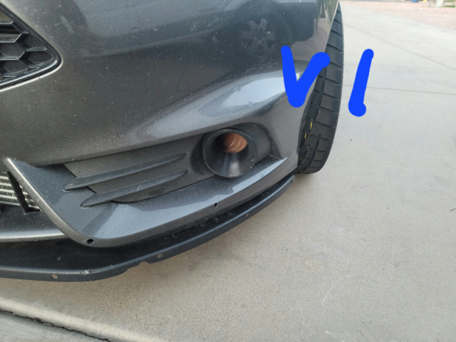

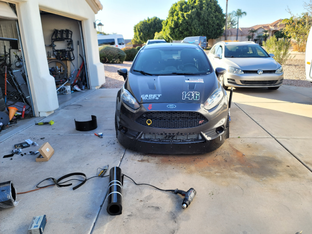

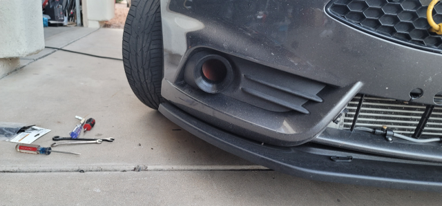

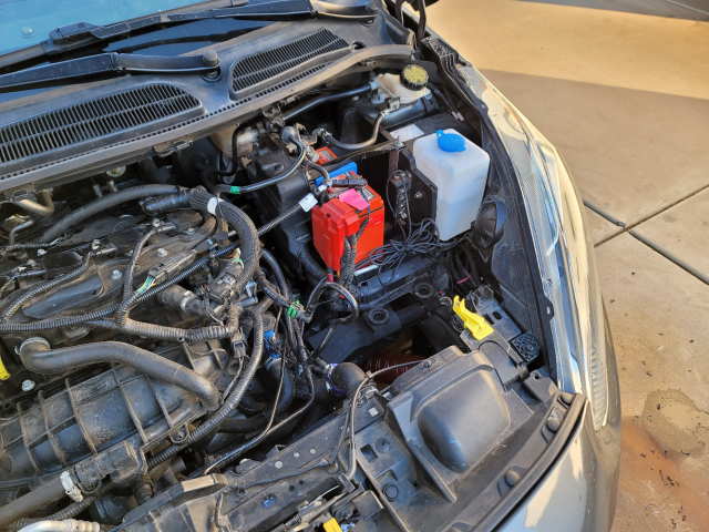

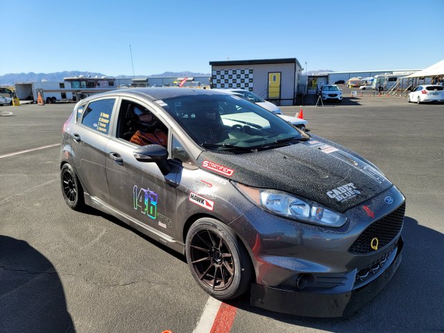

Getting ready to inprve the car further. One issue was brake cooling. We made some funnels for the fog light holes on the 3D printer and ran them to the back of the brakes with 3" hose. Hopefully get our temps down from ~1500F... Had to remove factort washer bottle and replace with a small 1L tank for our intercooler sprayer.
Also made a front air dam to help with drag and lift a little. Not pretty, but hopefully effective.

Latest NASA TT5 event was at Chuckwalla Raceway CW 2/19-2/20. We came away with a win on both days. I drove and won Saturday, and my son won on Sunday. We were both new to the track, but the car was super fast and worked really well with the Gripper diff and S280 kit. We laid down a best of 2:00.94, only 1 second off of the TT5 lap recrord.
The new NASA rules for TT5 allowed us to gain almost 30hp from last year, and the S280 kit and Stratified tune did wonders for power. The car was great. We also started using the Wilwood BP-30 compound pads, and they last way longer than anything we have tried from Hawk or even Carbotech. We did crack a rotor which is an issue we will need to come up with a solution for though. We are getting brake temps up to 1500F in the front. Working on some new brake duct designs....and trying to figure out how to maybe fit larger rotors with the help of Fastbrakes.com....
Not too much new to say otherwise. Car was fast, plate diff is the best thing ever, and S280 is a great turbo kit and Stratified tunes are awesome.

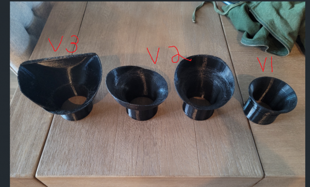

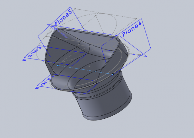

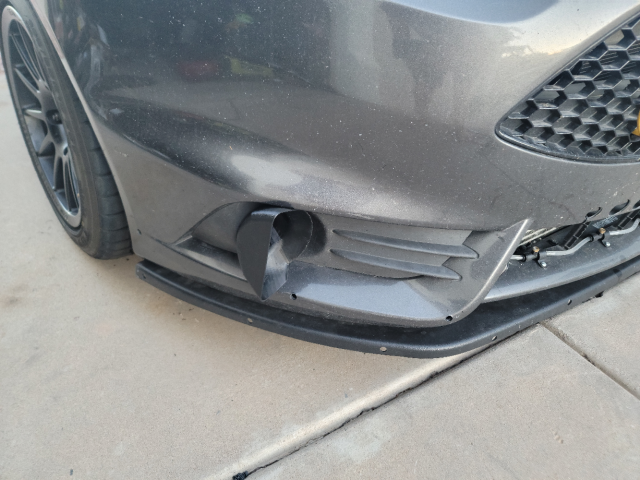

Brake temps.....That is currently the weakest point of the car. The brakes work at all times, but we are cracking rotors fairly fast. Temp paint shows us hitting 1500+. So we are working wth Fastbrakes to fit some wider rotors with more mass, and we are trying to make more efficient ducts for the fog light locations. We are pretty happy with the latest version and will try them at the track next time. The first version did function better than our under-car valences ducts, but still arent large enough to move enough air. We are trying to make the entire "fog light recess area" into part of the collector with the latest revision. See pictures for details. The 4 collectors in the image on the table are ones we were not happy with for one reason or another. These are 3D printed with PETG and connect to 3" duct hose.
