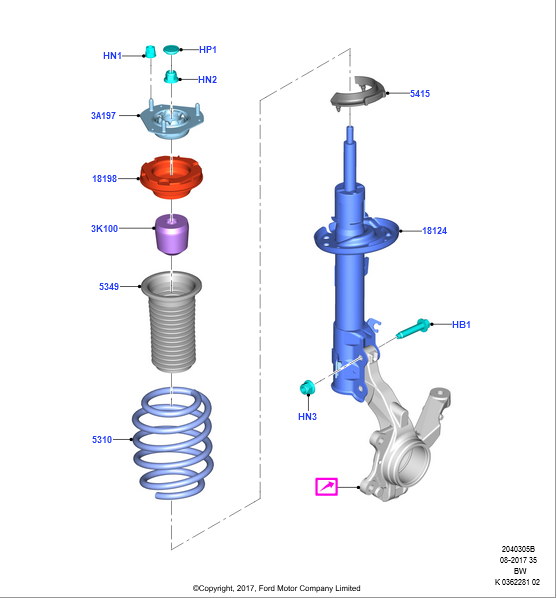

The fiesta suspension has the damper assembly mounting point for parts
Part#: C1BZ3F690A RH
Part#: C1BZ3C157A LH
and the suspension control arm bumper
Part#: AD1131 (D2BZ18198A)
the rear shock absorber
for the fiesta
Part #: ASH85849 (C1BZ18125N)
Weight: 5.0 lbs
Dimensions: 5.31 L x 3.81 W x 29.94 H in
