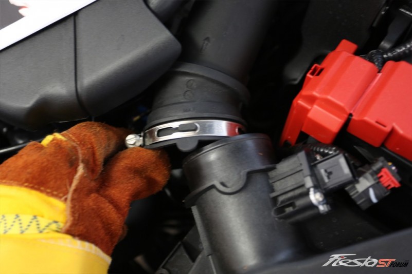

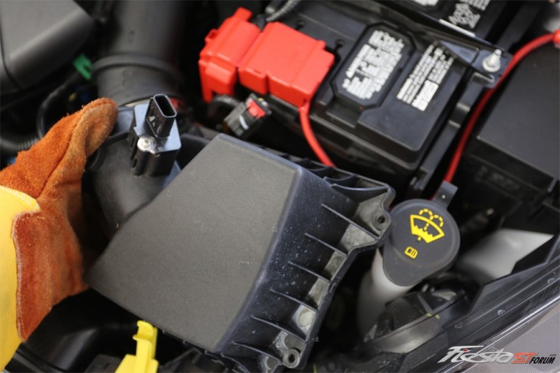

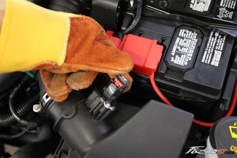

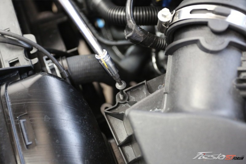

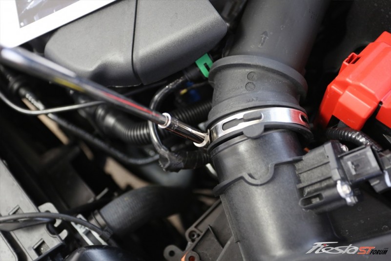

Step 1 - Undo the MAF Sensor
Step 2 - Use a 7mm socket, loosen and undo the air intake hose.
Step 3 - Use the Torx Screwdriver and remove the four screws holding the top portion of the intake box.
Step 4 - Remove the top portion of the intake box.
Step 5 - Remove the filter and replace it with either a new one or the K&N Drop in filter.
