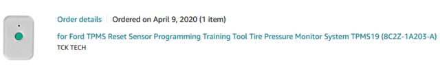

its easy to get them to learn if you have the little tool. I bought a pair of Amazon and have a spare if anyone wants it. $7.50 plus shipping. Though ya all you have to do is get the system going in learn mode then point the little tool at the base of your valve stem when you hear your horn honk once move on to the opposite wheel aka left front to right front to right rear to left rear. After each honk move on. Once done turn the ignition off and restart the car and you should be good to go . I have done on multiple wheel sets no problem.
I'll take it from you, I'm having a malfunction on one of my sensors and it's getting annoying.

If you're using the device that is pictured at the start of the thread it works by putting it against the sidewall at the location of the valve stem and pressing the button. I press and hold until I hear the horn beep, which takes maybe 1 second.
I have had problems with new TPMS that were just dead. To try to diagnose that, instead of starting at drivers front tire, try the passenger front tire. It won't program the TPMS correctly, but if you get a beep there it means your driver front TPMS sensor is dead.
