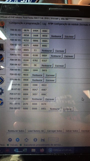

Hello everybody, I upgraded from sync 1 (1.1) to sync 3 (3.0), on my fiesta mk7,5 . the screen 6.5in. Before the update i have an options to reset tire pressure on sync menu. After the upgrade, the option no longer exists, even after activating the option in APIM module. However, the warning light on the panel is normal. Can anyone help?
After the sync3 upgrade and activating the option through forscan did you do a hard reset to the unit?

I think he meant did you do a master reset? Either from menu or pull the fuse. It should be reset after you change anything in ForScan.
