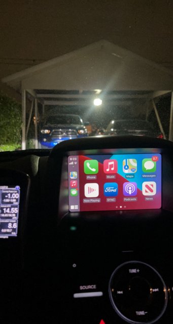

Alright, so new unit is installed and working great. All that was needed was this code change:
7D0-01-02: x2xx xxxx xxxx
Needed to be updated from version 1.0 to 3.0 which I was able to do without first going to 2.2 so that was easy. For some reason I was getting a navigation fault at first but after doing a master reset (after the Forscan flashing and the updating), it’s working without issue. View attachment 26310
My Sync 3 still has version 1.0 but I was able to enable the NAV with these setting changes. Thanks so much for that. I used my old As-built and just changed what you recommended and it worked perfectly.

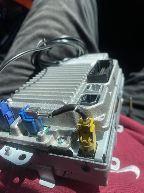

So I got around to installing my head unit out of a ‘16 and I noticed it wasn’t turning on, so then I noticed the wire that connects the screen to the “brain” was cut by the wrecker. It seems hard to repair since there’s like 4 small wires in there. Anyone have an extra they can sell? I contacted the seller hopefully they can somehow get me a new one. I found one on Amazon for like $20
Oh I'd be complaining to the wrecker and getting a new one.
They can get that item off any Ford screen, but they should be on the hook for it.
I contacted them and still nothing. I’m going to leave a bad review. I have a new connector on the way. Also gave Sync3 loaded into a USB. I can’t wait.. we’ll I hope that’s the issue cause if not imma be pissed

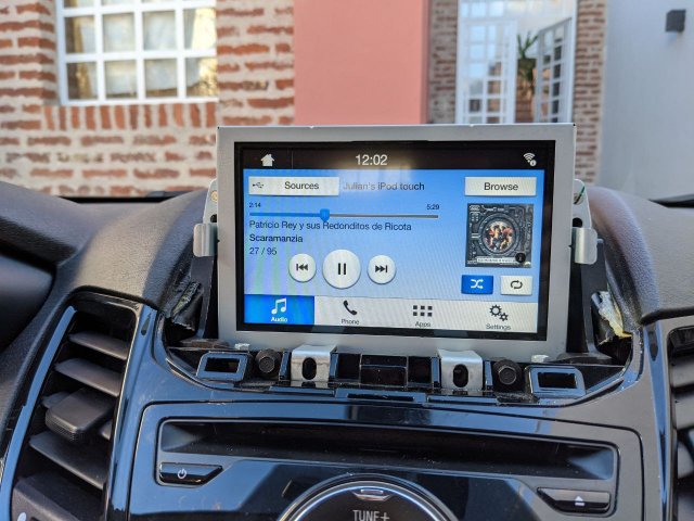

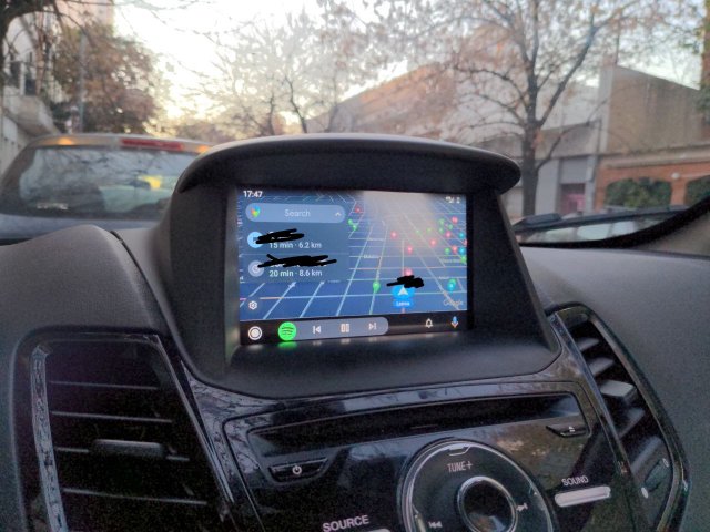

Hello everyone. Just as promised, parts arrived yesterday and the upgrade went swimmingly! The toughest part actually was to remove the plastic cover.
Everything works perfectly, which makes me wonder: I bought a non-nav APIM from a 2019 Fiesta, and I'm a little surprised I didn't need to program the APIM with Forscan, even the backup camera works just fine. Question is: will I have any issue? I plan to maybe update the software to Sync3 3.4 using Syn3 Updater (the APIM currently has 3.0), but don't want to risk a brick.
Thank you so much guys for all the data and help. You saved me a nice amount of $ as I was ready to purchase a kit that costs $929 and with this I spent less than $450.
