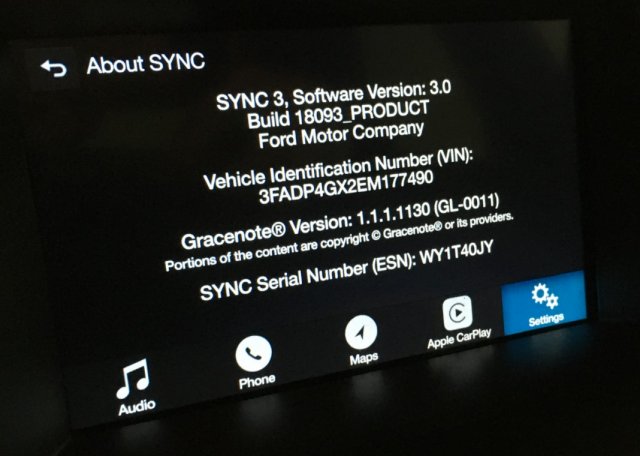

Alright, so new unit is installed and working great. All that was needed was this code change:
7D0-01-02: x2xx xxxx xxxx
Needed to be updated from version 1.0 to 3.0 which I was able to do without first going to 2.2 so that was easy. For some reason I was getting a navigation fault at first but after doing a master reset (after the Forscan flashing and the updating), it’s working without issue. 2E23AB80-9657-4677-9318-5683ECBEB1A0.jpeg
Needed to be updated from version 1.0 to 3.0 which I was able to do without first going to 2.2 so that was easy. For some reason I was getting a navigation fault at first but after doing a master reset (after the Forscan flashing and the updating), it’s working without issue. View attachment 26310

Did you update from Sync 2?
I previously updated from Sync 2 to a non-navigation Sync 3 setup. Found a deal on a Sync 3 navigation APIM I couldn’t pass up, so I just swapped that in.
The code change I mentioned was for swapping from a non-nav Sync 3 APIM to one with nav. I used Forscan to copy the current programming on my non-nav APIM, changed that one line, and wrote it to the new APIM. Worked great!
