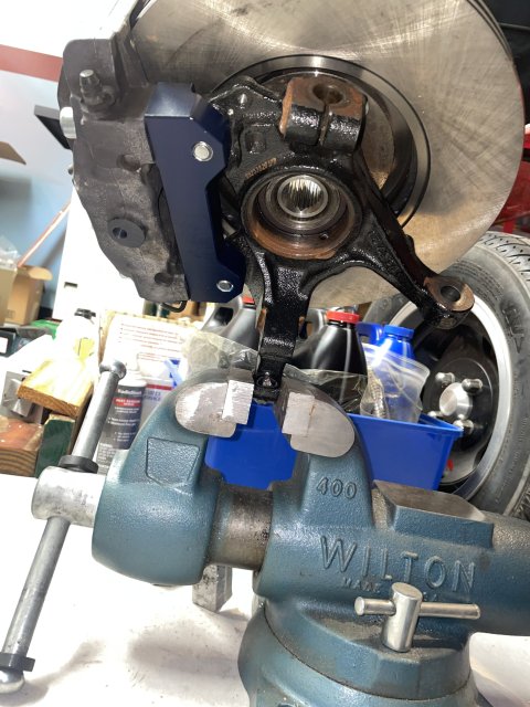

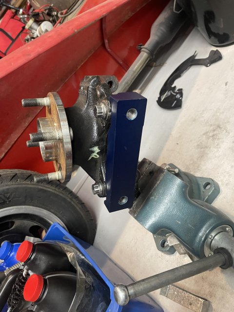

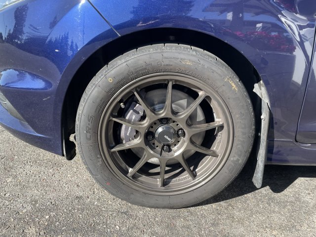

I recently completed a custom front brake kit using a set of 986 Boxster (non-S) calipers mated to 300x24mm bolt-on SVT Focus rotors.
I’m really quite happy with how they turned out, and in the process I ended up with a complete CAD design that I could, theoretically send out for quotes to local machine shops, if enough people would be interested in purchasing a set, which would mean getting at a minimum of 5 sets made to make the cost reasonable.

Fitment - They fit directly under my 16x8” Konig Dekagrams with no spacers required. The calipers stick out about 2-1/8” towards the spokes from where the factory FiST rotors sit, so you’d need about 2.25” of spoke clearance. (SVT rotors are at the same depth). I haven’t verified fit with any other wheels except my Autech 16x7” ET38 snow tires, which also fit. Some 15” wheels might also fit, but I’ve not verified any other wheel fitments. Unfortunately factory FiST wheels would not fit without spacers. There might be a different solution for that, but I haven’t had the time, money or motivation at this stage to develop that since they wouldn’t work for my setup.

- 2x Brackets for adapting calipers to the Fiesta ST front hubs
- 4x Grade 12.9 Bolts for attaching the calipers to the brackets

The brackets would be machined from 6061-T6 Aluminum, Hard Anodized for corrosion resistance and installed with Helicoil threaded inserts so you don’t have to deal with the downsides of threading steel bolts into relatively soft aluminum. At the moment I’ve redesigned them to reuse the stock caliper mounting bolts for ease of install instead of the ARP’s I used for my build, but could reconsider that if people would rather spend the extra coin on the ARP’s (an extra $60-70)

that would be a great option if it would clear 16x8 +38 enkei rpf-1’s. the wheels are notorious for poor caliper clearance. My guess is the similarly sized Dekagrams would have a bit more caliper clearance.

As mentioned before, you’ll need about 2.25” out from your stock rotor to spokes (the caliper sticks roughly 2.125” from the rotor)
