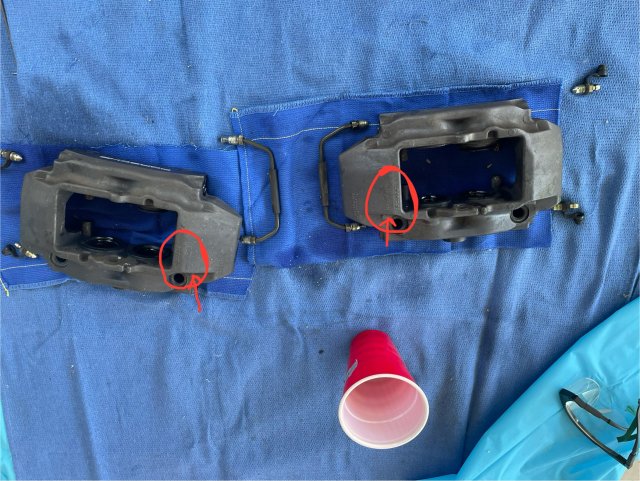

In the meantime, before you rush out and buy parts, these are the correct part numbers for the Boxster “non-S” calipers. Check before you buy as occasionally they’ll be advertised as the wrong type on eBay
The “Porsche” part numbers and Brembo part numbers are embossed in the castings as shown in the photo.
Porsche 986.351.421 (Brembo 20.6672.03)
Porsche 986.351.422 (Brembo 20.6672.04)
Incorrect part numbers are very close, so check carefully, ideally in photos of whatever you are buying.
- Incorrect “S” front calipers carry very similar “996” part numbers (996.351.425/426) Boxster S are painted red, but the base 911 uses the same caliper which are grey, Brembo part contains “7069”
- Incorrect non-S Rear calipers end in “423” and “424” (986.351.423/424). Casting numbers are also usually on the underside of the caliper and also carry “6679” Brembo part numbers
- Incorrect “rear” calipers from 986 Boxster S and 996 911’s have very similar numbers beginning in “996” instead of “986” and Brembo numbers containing “6679” (996.351.421/422) and can be red or grey. These maybe actually the same as the non-S rear calipers, but are still wrong
