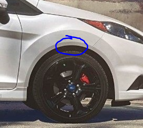

Check the inside of the fender and the fender liner here. You'll see some wear if this is where you're rubbing. This is where I was rubbing on the fender inner lip and the liner until I rolled in the lip and used a piece of rubber to push the liner up.
I was rubbing ONLY when wheels straight and hitting bumps and this was where it was.

Ya thats the area I am rubbing under extreme compression. and I am going to be rolling my inner lip as well.
