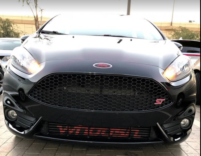

I have stage 1 and E30 from Dizzy, waiting until i get my FMIC for christmas to load my E30, just for delayed gratification purposes.
When you do get your intercooler, I highly recommend a Whoosh V3. It dramatically reduces charge temps and is an amazing deal. Besides that, the Bravo Alpha is another great one and is the biggest intercoolers you can get without a lot of cutting. The install is simple enough too. Just get some hair spray and extra clamps for the charge pipes and you're good to go!
I’ve tasked my wife with getting me a V3 for Xmas. Now I just wait.
Good luck! Also, Ron will spray his logo on it if you ask him too. It's pretty dope when you take out the horizontal bottom grill. Also his street spec rmm is a dream as well. Just bring a rubber mallet and some lube when you try and install it.

Anything more than a V1 is a waste on a stock turbo, to be clear, anything bigger is for added cooling on turbo upgraded cars.. but I do agree the V3 is the sweet spot if you are stock for now and might upgrade to hybrid later...
That was my mindset when I bought it. I'd rather spend the extra $100 on the off chance I do upgrade the turbo in the future.
I would love yellow, but his is a bit to bright for me. I’m picky on my color matching.
I’ve had his RMM on for a few months and it’s been great.
