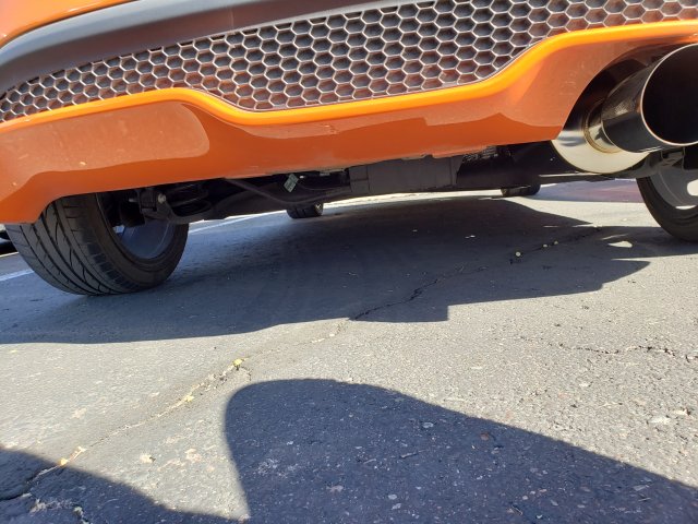

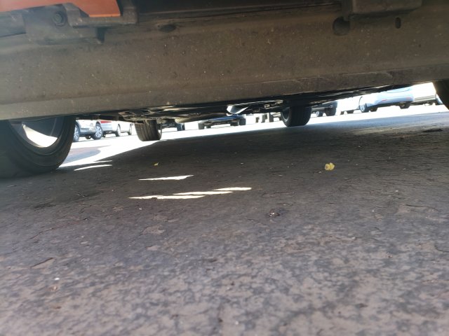

Don’t know what else to do to make it go up a little more
Can others confirm this hangs that low? I love the single exit tip, but I drive on rough terrain occasionally and that elbow would get damaged.
Mine was hanging low when I first installed it but when I went back thru to see if was hitting or rubbing anywhere I loosened the S pipe and pushed it up further. I used my jack to hold it in place while I retightened it and it probably went up an inch or so. 20211110_135245.jpg 20211110_135324.jpg
