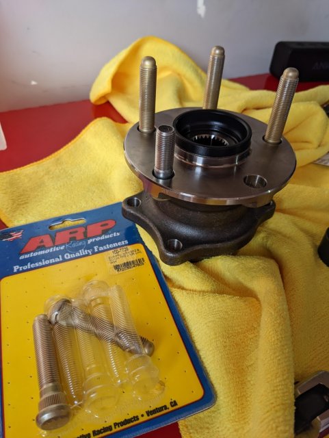

I have these spacers on my FRS
- The provided studs are about 10mm longer than OEM. I didn't use the lugs as I went with ARP studs. I didn't think the H&R studs were as high quality as the ARP, and I didn't think they would hold up to Cleveland winters long term.
- They are hub centric and have really good machining tolerances. Very impressed
So far so good with these. Pretty happy

2.535" https://arp-bolts.com/kits/arpkit-detail.php?RecordID=5168
also, FWIW rule of thumb is you can do up to 3mm spacers on OEM studs. any more and you really need to upgrade studs.
edit - had wrong ARP part #
I got the 5mm spacers, so I'll prob just use the H&R lug bolts for now. I should've ordered the ARP ones and did it all in one shot, but, I guess I messed up. I'll change them out later.

Do you have to take the hub off to replace the lug bolts, or can they be changed with them on the car?
Really depends on the car and the length of the new studs.
Can't speak for the Fiesta, but on the Scion you can do them on the car no problem. I was replacing all 4 anyways due to the age of the car and wanting a project, so it was pretty easy.
Ball joint removal tool makes it easy to press out the old studs. I use this tool to install the studs. Makes it really easy. https://www.amazon.com/gp/product/B000ETUD22/ref=ppx_yo_dt_b_search_asin_title?ie=UTF8&psc=1

I was able to change mine with the hubs still on the car. You can rotate the hub to a certain point and they come in and out easily. I have the same ARP studs as above
I used one of my factory lug nuts (I didn't intend to reuse them) and tapped the old studs out with a dead blow. Doesn't take much effort.
I used this to install the new lugs. Pretty easy job

Same install tool I used and linked above. Thing works great.
Just know that the bearing on the back of the tool is intended to be a wear item, and some people have reported issues with the bearing falling apart if you use an impact. I just used hand tools when installing my studs.

Same. I used no power tools. Just a standard socket wrench. They went in easier than expected.
