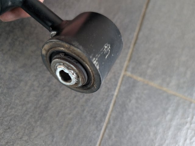

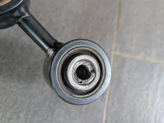

Turns out the failure was much more comprehensive than just the bolt, completely lost the cylinder end of the mount that goes to the transmission which one can notice in the first pics but I missed that on a quick look. Unfortunately I don't think their warranty would cover since it's been more than a year and under "competition" use. I really like this mount but hard to say what caused the failure ultimately, and need to decide what to replace it with. Launches were never above 4k rpm but it did see plenty of autox and hard track use. 1000006028.jpg 1000006027.jpg

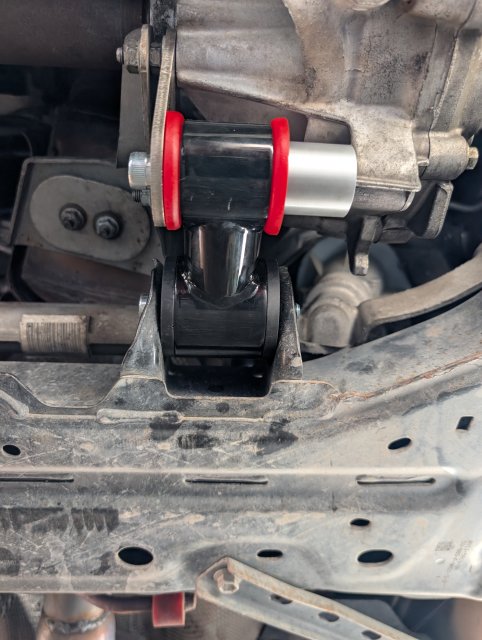

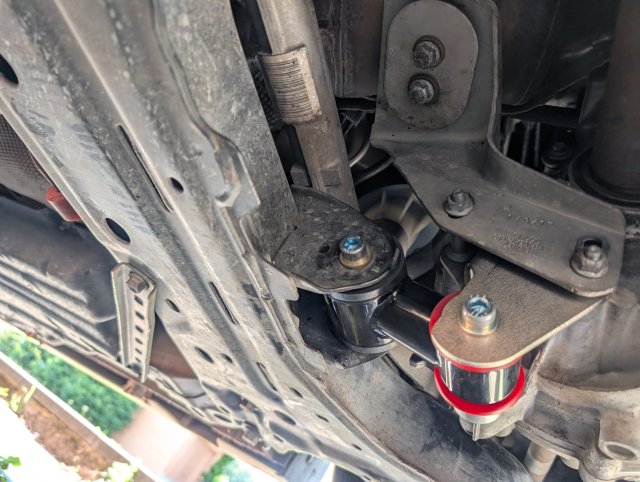

AWR mount and whoosh bolts installed with a tiny bit of blue loctite, just in time to hopefully run the ring with Lemon this weekend. Really like how it includes its own bracket vs the Vibra. Will definitely incorporate more bolt checks this time around during oil changes just in case.

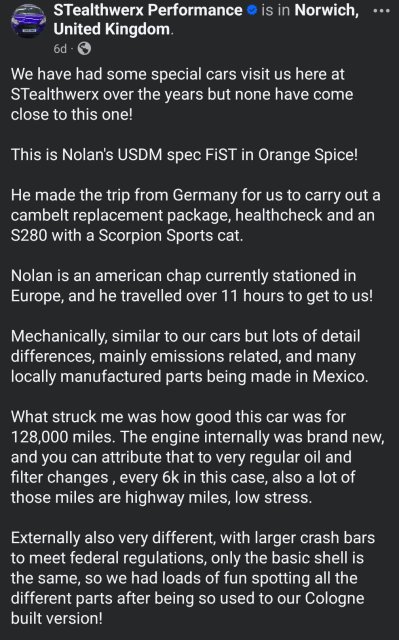

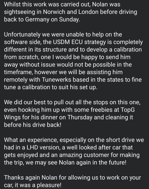

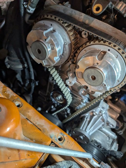

Big update time: took the bean across the channel to STealthwerx in the UK for some maintenance and upgrades! It's a really amazing shop, Gareth knows these cars inside and out which showed instantly. He's super passionate to make sure every customer is taken care of with no BS. Here's his summary of everything that was done since I can't say it better myself:

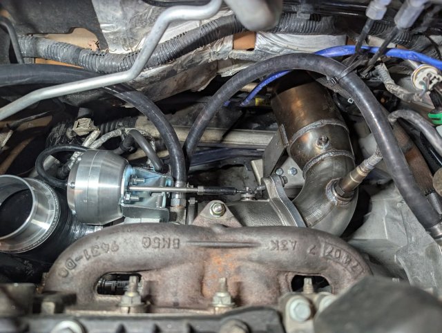

They also upgraded me to a ST200 airbox for no extra monies, and gave her a much needed bath. Currently working with Tunewerks again to get the software sorted for 93, so I haven't gotten to see what the s280 can do full tilt but I rode along in theirs and it's pretty insane so I can't wait. Will be using the Turbosmart 7psi actuator but they gave me an extra spring in case we need to up it to 14. Even on low boost it gives the car a completely different feel and sounds like a jet engine. I have a track day at the Nordschleife in early November which will be slightly terrifying, hopefully the weather holds out for that. Next up for the bean will just be fresh pads for the ring, likely the GLOC R14s again.

Interesting, I wonder what did he mean by "completely different USDM ECU strategy / structure"

I'm not a tuner so don't quote me but the main issue was boost control on the top end that they needed more time with, and I assume with that he's talking about the MAP on our cars vs MAF on the EU/UK.
I mean, it is completely different tuning wise to EU, in hindsight I would of needed double the allocated time to sign off a tune I would of been happy with. There was a couple of load limits being hit at higher rpm to finish but even then, I would of wanted to put some decent miles on it to verify no driveability issues especially on a car that isn't local, the most important thing is customer support long term and reliability.
Regardless it was a great experience for us to deal with something the same but also very different, having spent 10+ years on EU Fiesta ST's, the amount of detail differences kept me amused for hours!:ROFLMAO:
Bit late but thanks again Nolan for one of the highlights of our year and hope we can help you along the way in the future.
