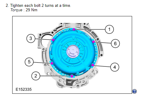

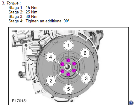

But, someone will chime in with the manual's torque specs, hopefully. [wink]
