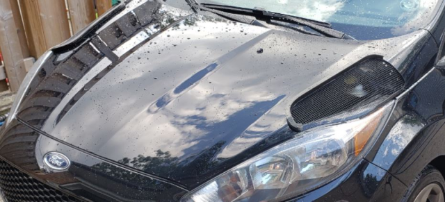

Here are the vents that we run. When ambient temperatures are in the 96+F range with humidity, the hood vents were good for ~ 10-15F.
Without the vents the car would hit 235-240, and start to pull power on clear empty track
With the vents the coolant temp was 215-225, and when not running a time attack style session temps were 205-210.

What I'd love to see is you running something like another hood with the verus vents and the results with that as I'm curious as to any differences regarding position.
Aside from those temps I suspect there are other hotspots under the hood that get some benefits from vents that we aren't aware of. Luckily we have to mainly just worry about the brakes and fluids compared to heat expanding hoses so they come into contact with radiator fans or frying coils but, again, that doesn't mean components don't benefit from the vents.
I love the idea of the vents and the looks (well, not all of them) I just wish we had more details. All of this stuff is pretty rad, though, so keep it up, gents
Oh, as an aside, I'd love to see how vents look in the winter.

I don't know of anyone that has a verus vented hood to swap and test. However, from a post on the forum I thought I read it would actually put air into the engine bay, instead of acting as an extractor. I have not confirmed this.
We have had pretty good results to date with the Msport hood vents, but I have never ran them in the winter and added a water deflector to ensure water stays off the fuse panel in the summer. The factory hood goes back on after race/track season.
