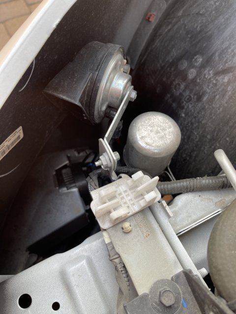

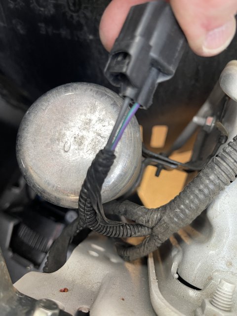

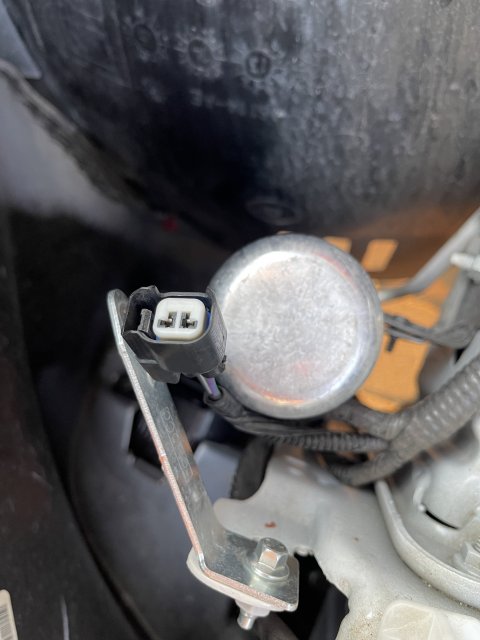

So there we have it.
Dual Horn:
2014
2015
2016
2017
Single Horn:
2018
2019
I guess I'm here to confirm that my 2019 only has a single horn!
The question is, is the harness on the 2014-2017 a single wire around 14ga that splits into two hot wires for the dual horns, or is it a thicker guage through the harness from the split? Or is it dual wires?
I'm getting ready to install Dual Hellas on my 2019 with a single horn, however I'd rather not have to build a new harness for the dual horns if I can avoid it.

Did you tap into the stock single hot wire and run it to both horns without issue?
I did indeed. I liked the combination of sound and ease of wiring. Pulling the headlight out was the hardest part but it wasn't even that bad.
Meant to add there's plenty of room to put a second horn where the stock one is located.

The power draw spec should be listed with the replacement horns. As long as the combined horns don't exceed or equal what's on the fuse for the circuit, should be fine.

Direct swap. No splicing needed. I’ll verify, but I’m 99% certain I added the second horn without issue.
