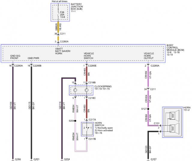

Are you able to check for voltage?
Also, I only have the manual for the 2014 and I'm not sure how different these diagrams are going to be for your 2016 but maybe this can help you troubleshoot the issue
I would start checking the connections and making sure they are good. If that doesn't help, you can download the workshop manual from this thread and go through the troubleshooting process of checking for open circuits, voltage etc...
https://www.fiestastforum.com/threads/service-manuals.8653/page-2
Again, keep in mind that what I sent you and that workshop manual is for a 2014 so things may be different for your 2016
That's very cool, I need to find a manual for my year. Electronic is a bit of a weak point for me So I'll have to investigate further on youtube. I found info on another forum and that person mentioned a Multifunction Control Module (AV1T-15K600-LK) as being the culprit. He never followed up though if that fixed the horn problem for him.
