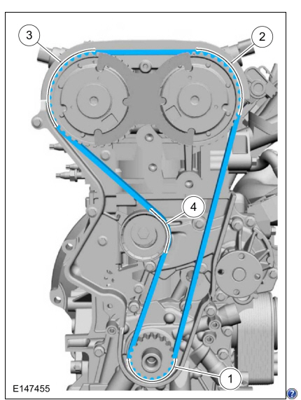

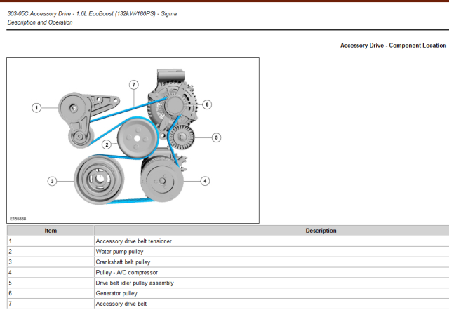

Curious about the reason for the question? Unless you're consistently in an unusually frigid/hot environment that oil will do fine.
The only belts these vehicles have are the serpentine (aka Accessory Drive) and timing belt.
No known issues with what is presumably a gear driven oil pump.

Ours are Dry Belt* The 1.0L Ecoboost were the Wet timing belt type.[driving]
