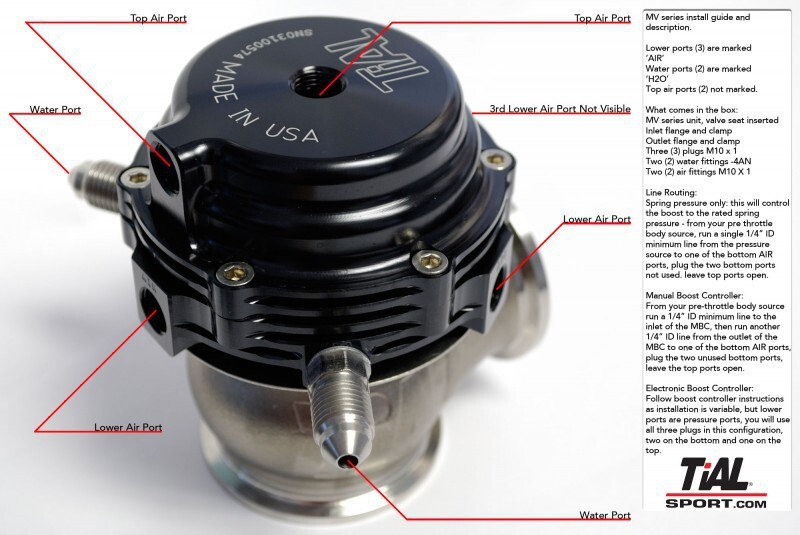

Ahh dang. Waht's the setup for the EWG? I Basically have the copy cat version of this with no EWG. (I wish I could just call Russ)

Yeah I cant imagine they will have too much issue. Never heard of problems with people that change DP's with more miles than I have. At least locally, so I think I will be fine. I will check em out tho. If I need to make parts runs I will be able to thanks to my non daily. Just excited to get it all done. Quick question, did you go with the uprated WGA? I did, but I havent seen much on people that have chosen it vs the standard.

Brura22 has, I did not. I am on crap 91 octane so I won't be making huge gains anyways. He has said it makes a huge difference. I was looking for more oomph and want to be around the 250-270hp range as this is my daily and I want to keep it until the apocalypse lol. Bruras write up is good too unser the MRX turbo thread. I think its around the 150 page range (I did months of reading before pulling the trigger).
