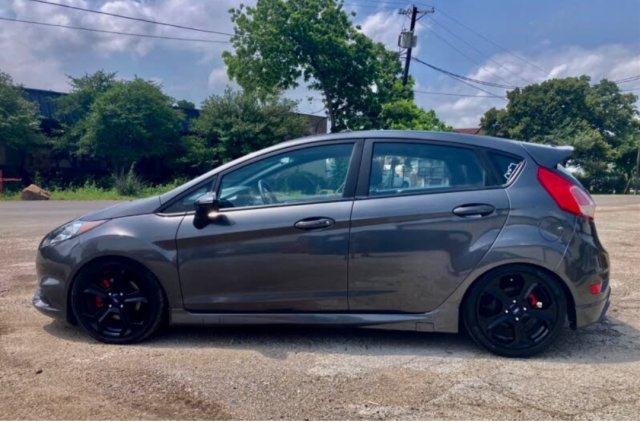

Only parts purchased for this car so far is hyper black ROTA Titans (probably the last set of hyper black 17x8 4x108 40 offset in the U.S., 215/40-17 Direzza Zllls and a coilover set up. Car is sitting too low for my liking and rides like sh*t but I'm not complaining.
Windows need tinting. I'm going to have to go over this car with caution as it already has a serious drop with lowering springs and an aftermarket radiator. It may also already have an upgraded intercooler, I just can't tell.
