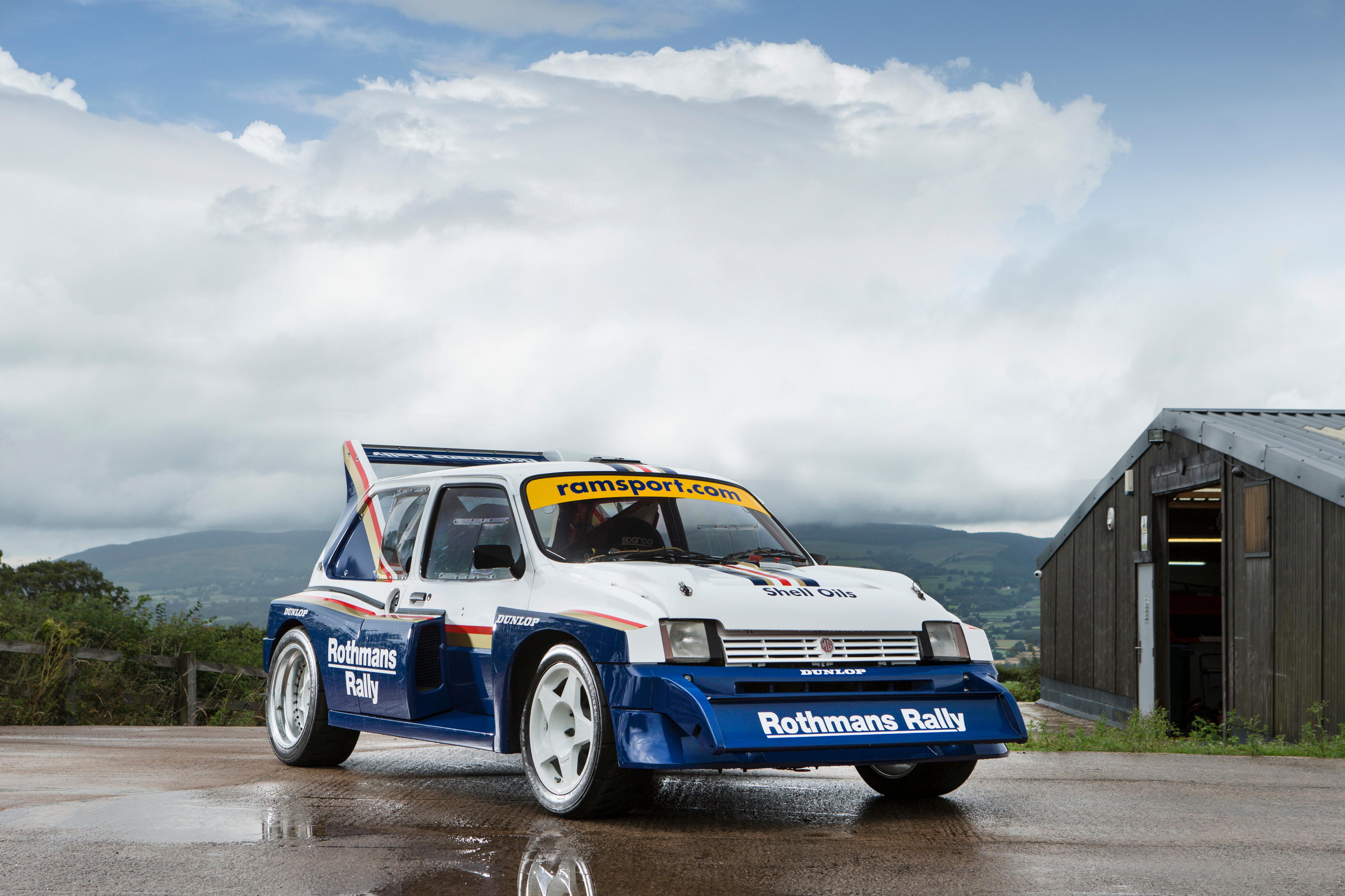

I've always hated those anyway. They look like 80s rally throwbacks.

LOL yea i love rally racing actually, i wish the states had more support for it rather than drags and Nascar. But those 80s cars were pretty ugly, 70s too IMO. By the 90s they started to look better. Today's cars i think have a bit of retro look like an 80s model, and even with regular street cars. I blame Transformers, my favorite childhood cartoon.

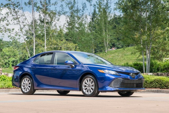

If you look at even family cars like the Camry, it's ridiculous, big blocky gaudy chunky shapes, kinda like some 80s cars. I prefer more streamlined, like a FIST or the beautiful 2004-2006 GTO. The newer cars like the camera look like one of those rappers always showing their fake teeth. 2018-Toyota-Camry.jpg 1381527506_aaaac0ec2809f9f0054be56aca2faccc.jpg
