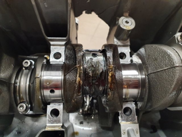

I bought the race short motor from them, which was supposed to take any abuse I can give it, at least 400+hp and 8000 RPM rev limit. I gave it 310hp and 7200 RPM and it threw a rod after 5km...so in addition to the block being a pile of scrap metal now, I also have to repair the head, rebuild the turbo, fit a new Titan drysump pump, new oil pump, new oil cooler etc.
Quite an expensive incident, wouldn't want anyone else to run into a similar one, still waiting for any reasonable answers from Pumaspeed...

PEC H-beams. But the beams can take it, problem is bearing/clearance/oil related, as other big ends are still in one piece but have serious marks of wear and would have also failed very early. I also have previously ordered another set of new PEC rods+ACL Race bearings and when directly installing them to the engine, the oil clearance is too small for high hp application. It seems the built-up short motor was also assembled without making any changes to the crank journals to achieve proper clearances. I would suggest you check yours with Plastigauge when the engine arrives.
What oil you plan to use?
