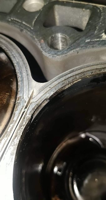

The MRX seems to still have the gap between cylinders, do you know how they have eliminated this common 1.6 Ecoboost failure from happening? Cylinders can still expand towards each other through these gaps.

https://www.mountuneusa.com/mountune-MRX-1-6L-EcoBoost-Short-Block-Engine-p/6064-sb-160a.htm yes it does seem to have the gap still but all pumaspeed did was put a shim in it. To be honest with you I'm not too concerned with it. I have liners now so the amount of stress it can handle with be far more. The gap seems smaller in the mrx motor though than the stock motor pumaspeed took a picture of.
Attached are photos of my first engine. It drove 250 competitive miles from brand new under 1.6 bars of boost. Gap between cylinders gave way for distortion which in return also took a piece out of the top aluminium "ring".
I e-mailed mountune about it concerning the MRX, waiting for a reply now. Haven't seen the MRX built-up block with cylinder support before on their page, must be quite a new addition to their product line?
