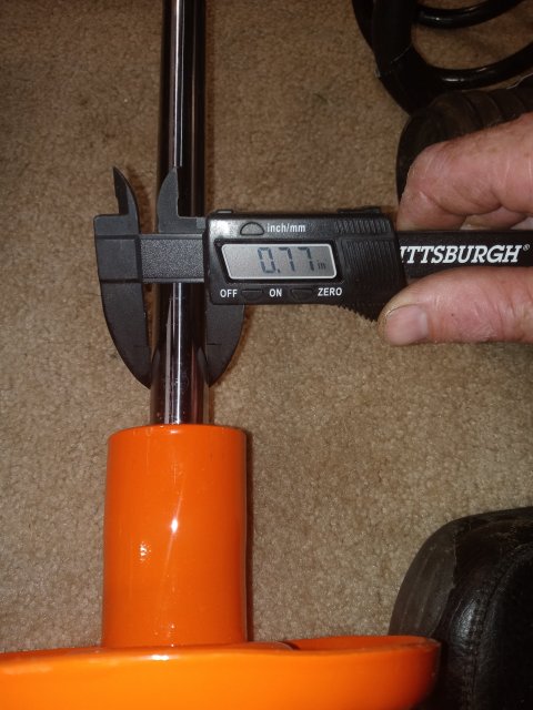

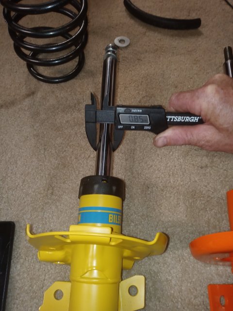

The stock springs are not the problem. The stock dampers are pretty harsh. I had Koni Sports on both stock and then on Eibach sportline coils. Either is ok.
The Bilstein B6 is not adjustable and not really comparable to the Koni Sports.
The B6 is probably closer to the Koni STR-T in ride and handling. I have recently installed the B6's on a project hatchback Fiesta that I am working on. But haven't been able to drive it very hard yet. But the Bilsteins on the stock coils seem to provide a very controlled ride. They have a larger diameter piston than the Koni STR-T.
I consider them closer to what we might describe as a heavy duty damper. 20210516_110243.jpg 20210516_110259.jpg
I consider them closer to what we might describe as a heavy duty damper. View attachment 43708 View attachment 43709
So would you say that the Koni sports give a better performance in the ride and handling compromise?
