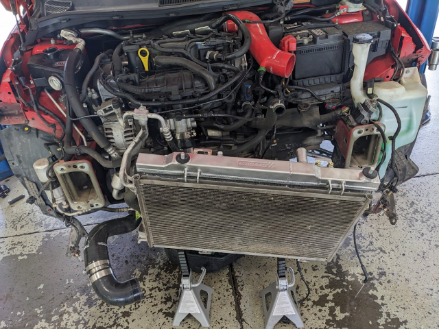

I just bought a Koyo triple pass radiator from whoosh and I haven't been able to find anything in the way of tips or things I should know about the install of the radiator. I was curious if anyone had and tips or tricks for installing the radiator? This is my first performance mod to my FIST and kinda my first big car project so I don't want to mess the install up. I was also curious to see if the mountune install was similar because then I could actually see an install video. Can anyone confirm this? Thanks for the help!

I did mine with the front end off and it made the job a whole lot easier.

The install for the Mountune and Koyo are probably 99% the same. Only small difference MAY be the lower brackets on the mountune are def removable and I dont know if the Koyo are or not.
