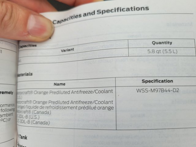

This discussion made me remember an earlier discussion on here where Ford had reported a larger capacity for one of the later year radiators on the spec sheet in the ST manual. Most people thought it was a typo, and I remember checking the part numbers for the 2018 and the 2019 radiators on Tasca Parts, and confirming that they have the same part number.
akiraproject24
U.S. Marine Veteran
1,056
1,233
Pennsylvania
Was it this? My 2019 Supplemental manual states 8.5 qts while the Owners manual states 5.8 qts. Thought typo but noticed the L also reflected the different amounts.
Capri to ST
1,624
2,036
CHAPEL HILL, NC, USA
I believe that was where the larger capacity was incorrectly reported. I double-checked the part numbers for the 2018 and the 2019 radiators, and again confirmed that they are the same, so I believe that the radiators are the same for all model years. The radiator part number for my 2016 is also the same as it is for those two years.The ST supplemental manual for my 2016 states a capacity of 6.1 quarts, or 5.8 L, and the regular owner's manual states the same thing.
I'm pretty certain that if Ford had in fact increased the capacity for the radiator for 2019, that it would have then had a different part number. Maybe one of the parts experts on here can chime in on that.
