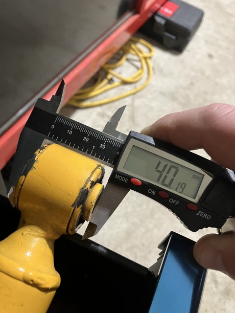

Be careful the Focus uses a larger lower eye bushing. Don't think it will fit in the lower shock mount. Can measure this based on the shock you sent me. I noticed it when I went to dyno it..
I’ve run the AGX Focus damper on my car. It fits and has a smaller eyelet. Some small washers to take up the slack was needed.
here are the measurements
