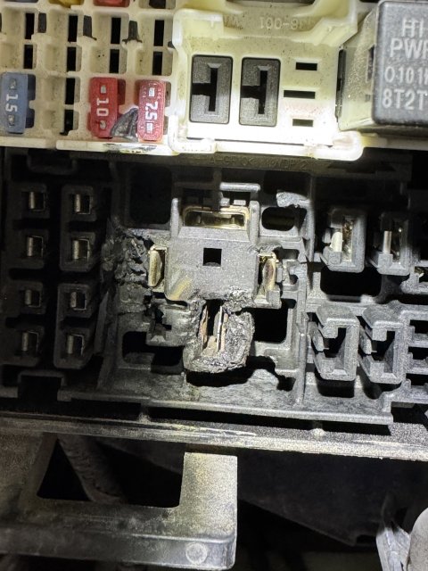

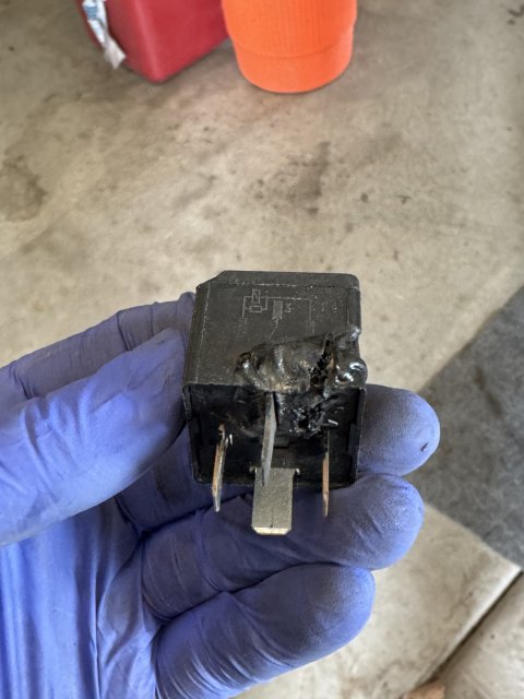

I have to switch out the high speed fan relay connector because it got all melted from poor contact / corrosion and I wanna know what sort of parameters I can expect when I am testing out my wiring and new relay function.

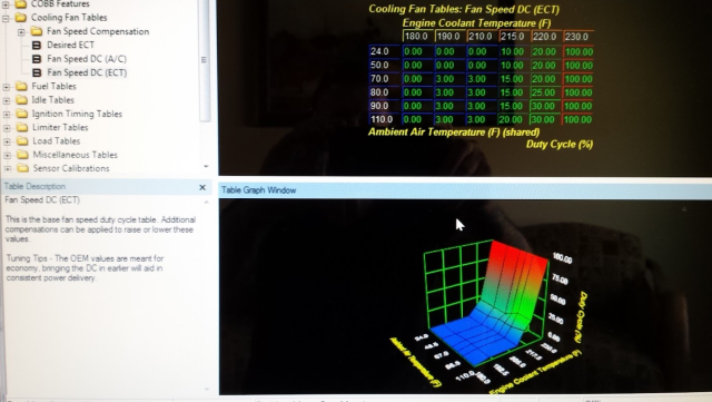

Here's a picture of a graph on this topic that somebody posted a while back. I saved it because I thought it might come in handy sometime. This may be of help to you
