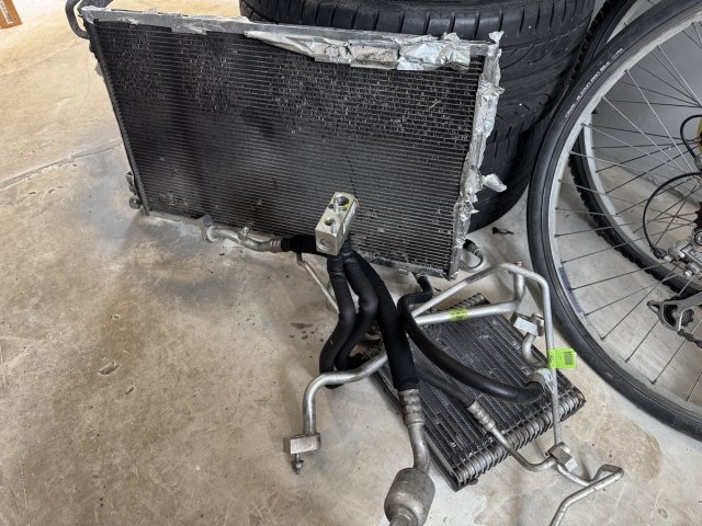

I've begun the next stage in the weight loss. I decided that I'm going to remove the AC and fit a small race heater for de-misting to supplement the heated front screen (which I'm shocked you don't get on the US cars).
I've ordered this AC delete pulley from SiCo Developments, and will soon pick up this heater. I'll run some ducting to the two outer vents and point them to the front windows.

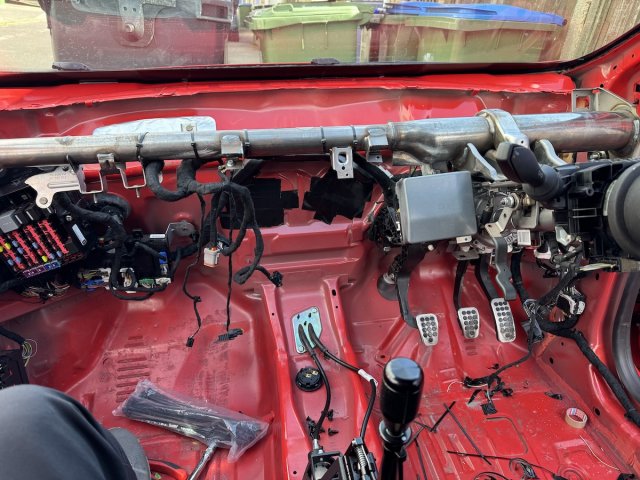

I removed the stock fan assembly today in preparation for all the other stuff. In order to remove this properly, it looks like you'd need to move the cross beam out, so I ended up settling for the destructive method. I then cut out all of the framing that was no longer needed.
Once the AC delete pulley arrives I will remove the radiator, and weld in some plates to block up the holes. At some point this year I will pull the loom and de-pin everything that's no longer needed.

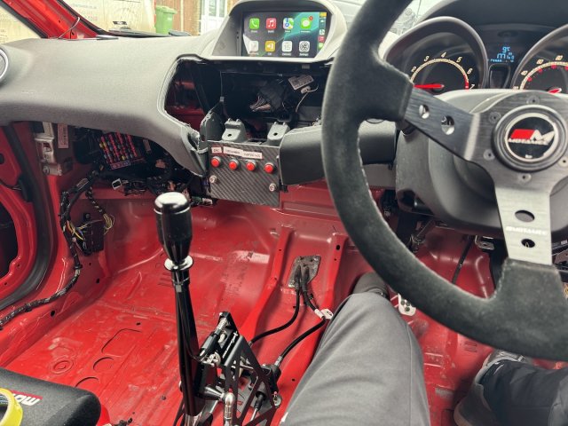

The AC is fully removed now, and I added a small carbon fibre panel to put switches in. It's not pretty, but good enough for a track car. I still haven't decided what race heater to go for. I've narrowed it down to either a 3.5kw (here) or 5kw (here) unit. Its only job will be to make it bearable in the winter, and to de-mist the door windows.

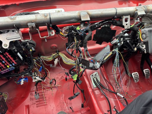

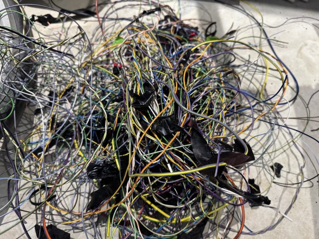

Spent some more time removing excess wiring and tidying up the mess I've made over the last few years. My goal is 999kg, which I think will be doable once the rear windows have been replaced with plastic, and potentially a lightweight race battery.
I removed quite a lot this time, fortunately everything that's still in the car works:
Here's what it looked like before:
And after:
And the final weight is 1040kg:

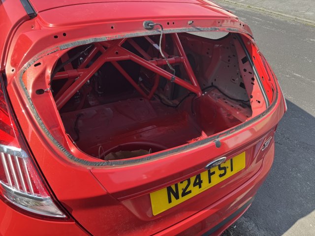

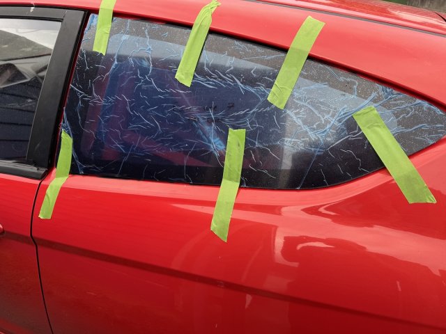

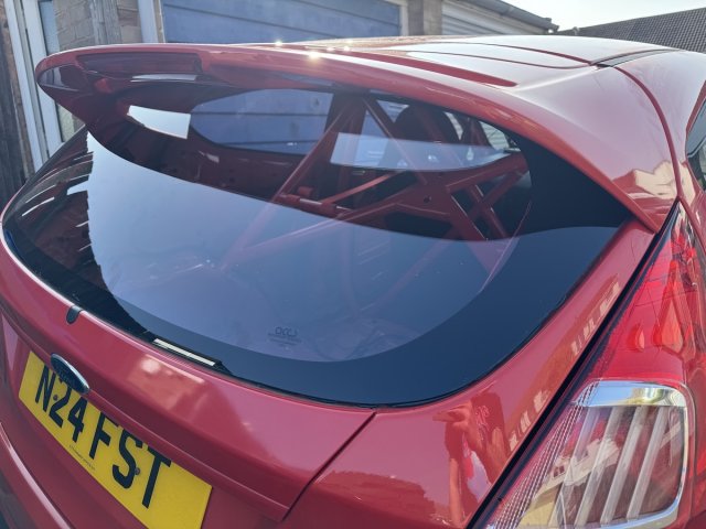

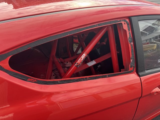

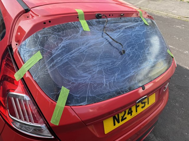

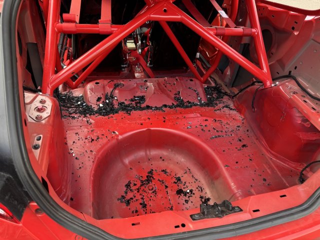

Plastic windows are in at the rear now too. I really did try and remove the old windows gently, but in the end had to resort to destruction.
Glued in:
And done:
I started with the side windows and make an absolute mess. I'll need to try and find a way of removing the excess adhesive. The rear turned out pretty good once I'd got some practice. I weighed the remains and it came to around 20kg, so I should be around 1020kg total now.

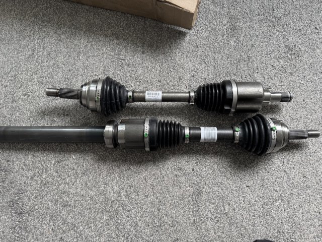

Also, ordered some new driveshafts fgrom Ford which I'll install this week:

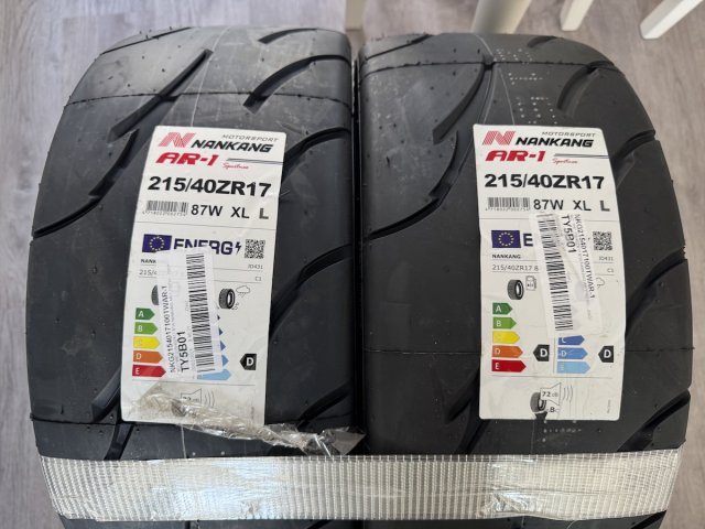

Picked up some Nankang AR1s to replace the front Avon ZZRs, they're pretty square so I hope they have enough clearance. Since swapping back to the road wheels I can no longer hear any weird noises from the front, so I'm praying that it was just the ruined tyres making all the noise.

The AR1s are basically THE widest tread width 215/40-17s on the market, at least among the >50 tread wear, any tread at all, DOT donuts. [thumb]
I was hoping to try and fit 235 in the front, but I’m not hopeful!

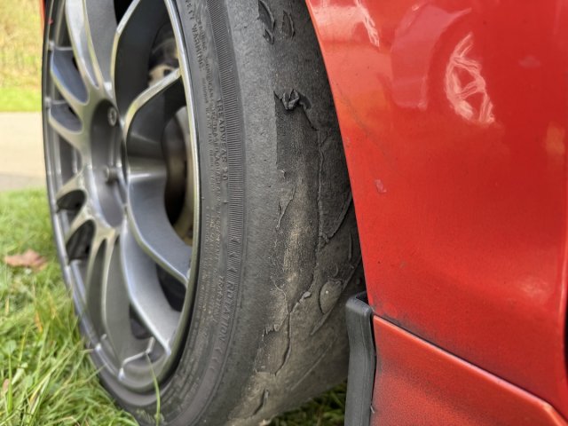

I was back at Castle Combe this week for a track day. This was a limited day so cost a little more, but there were only around 40 cars total, and no more than 13 out on track at once. The best time of the day was 1:18 which I'm really happy with!
I swapped cars with my friend in the EP3 in one of the pictures below for a session. It's quite amazing the difference in the feel between the two cars. While the EP3 had way more character, and the VTEC actuation made me giggle like a child, the Fiesta is just an all round superior car in my opinion.
For the second time this year at this track, I've ruined a set of tyres. The AR1s lasted two track days before looking like this! I'm going to rotate and try and get another track day out of them, but it's been quite an expensive learning exercise - I'll be going back to the Avon ZZRs next time. I might also try and add another degree of camber to even the wear out a bit more.
Also, the RPX have gone a pinky orange colour. Are they getting too hot? I have brake ducts but I wonder if I need to do something else. The brakes always feel incredible, but I'm slightly concerned with the colour.

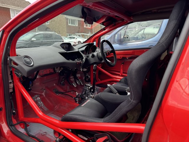

Full cage is in! It's a MSUK certified cage which will hopefully allow me to compete in some racing next year.
I need to replace some of the seam sealer, patch up the under seal and paint some sections inside the car, but functionally it's all there.
I see the pink on the rotor and in the j-grooves as well. It’s likely just surface rust/oxidation - happens when some pad compounds that are particularly dusty and either have a lot of iron in the pad compound, or are aggressive on the rotors. You can probably wipe or scrape the dust off the pad backing and see the original color underneath.
Mainly it’s a sign that you’re getting the rotors pretty hot.
Fusion Works
#10988
805
1,054
Does your cage go through the firewall and connect to the shock towers? Also there is no protection for your feet if you get in a bad front end crash. Could push a tire into the pedal area and break your ankles. Need two bars on each side going forward from the A-pillar down bar to the firewall to protect your feet.
Since you have a cage, you can now start cutting a LOT more material out of the chassis. Get a hole saw and spot weld cutter. Remove the door beams, (and fill the doors with IMPAXX foam), cut out all the material inside the hatch and inner quarters, trim the roof supports or put lots of holes in those parts.

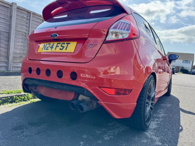

Made a change that I'm sure a bunch of people won't like! I removed the rear valance and drilled some holes in the bumper. I also discovered once it had been removed that it has a rear tow hook! Long term I would like to remove the spare wheel well to make room for a diffuser. MGC sell them over here in the UK.
As Fusion Works said in his comment, I think next steps will be trying to remove some mass from within the car such as the door bars and some of the extra material. The full cage weighs about 20kg more than the one I had before, so would like to make up the difference if I can.
