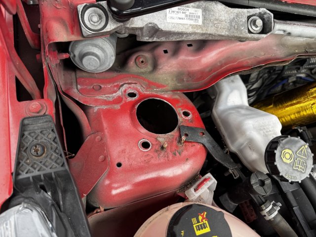

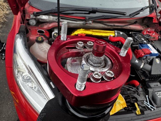

Today I widened the hole at the top to allow for more camber. I have seen some people on the UK sub that have opened the hole up almost to the bolts which allows access to the bolts on the camber plates, but I did not like the look of how little material there is. I decided to open it to 60mm so that the edges of the raised area still exist to add the extra strength.
How it looked before:

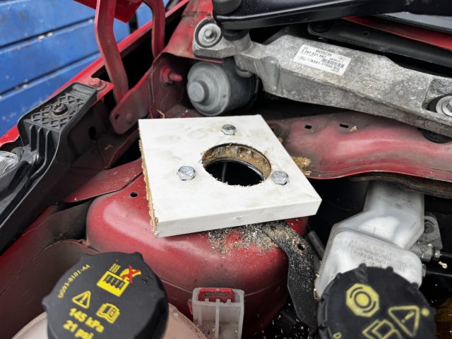

I made a small jig so that the hole saw wouldn't jump around:

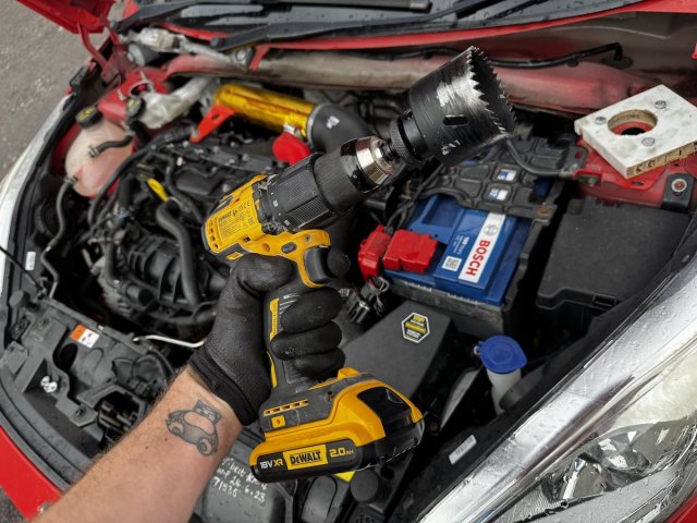

I used a cheap 60mm hole saw. I was worried that it would go blunt trying to cut through but it had no trouble whatsoever:

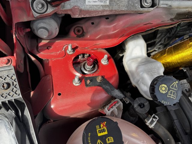

Unfortunately I still can't access the bolts on the camber plate without dropping the coilovers out. Although the hole would probably only need 10mm more or so wider, so I may consider this in the future:
I maxed out the camber plates just to see what the maximum camber would be:

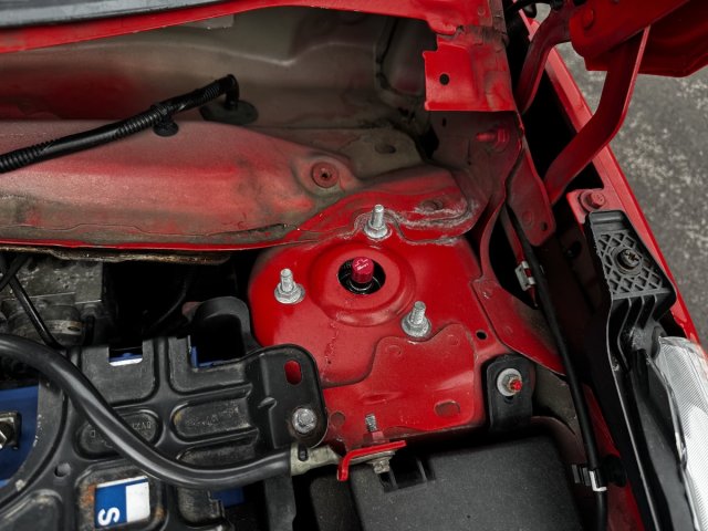

All back in and painted:

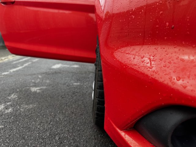

Oh lordy that's a lot of camber! I have no idea what it is at the moment, but if I end up with a similar amount of camber after the alignment I may need to add some spacers as the wheel now sits in way to far:
