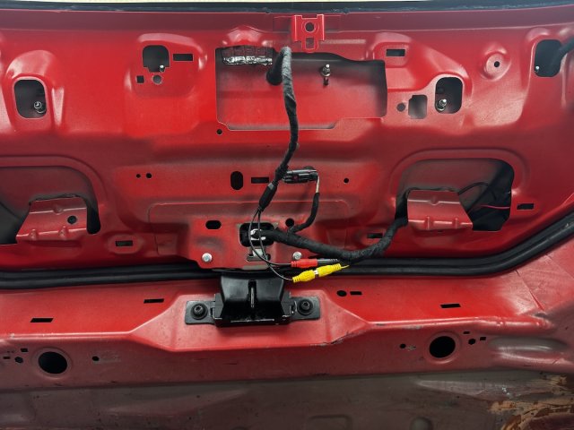

I recently removed the sliders from under the seat and fixed it in place to drop the seat down another inch. My head now clears the roll cage, but one side effect of this is that I now sit below the rear quarter window line and so my visibility when parking is pretty bad. I decided to fit a reverse camera to try and help - these are quite rare to find on UK cars as they were an expensive option. The whole install cost less than £30 and seems to be working pretty well.
It's quite difficult to see in this photo but it replaces one of the number plate lights:

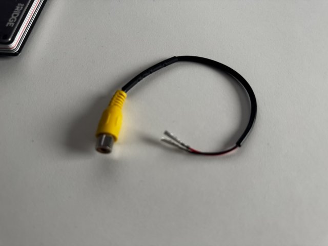

There's two missing pins on one of the Sync connectors that this cable goes into:

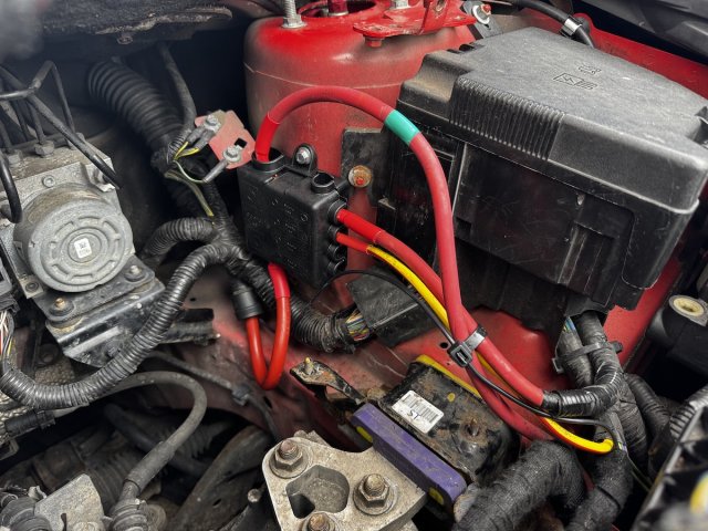

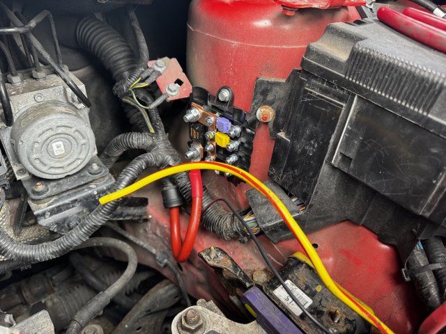

And finally ran the RCA cable and a feed from the ignition power:
