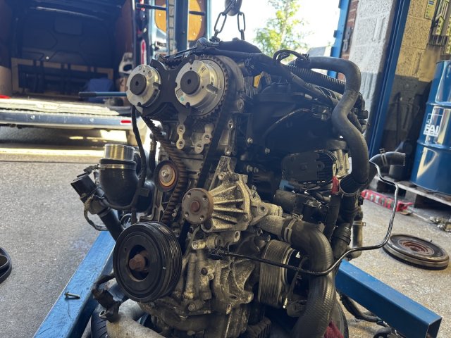

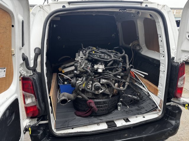

Picked up a replacement engine last week - JTJB engine on 55k miles with an S280.
Was a big day yesterday - firstly went to Thruxton to sit my ARDS exam which I passed. It's the exam you need to sit in the UK to get your MSUK competition race license. This will allow me to compete in circuit racing, Time Attack, hill climbing or anything else I might want to do. It starts with a classroom theory test and then you go out with an examiner on track and they asses your driving to see if they think you'd be safe in a grid full of other cars.

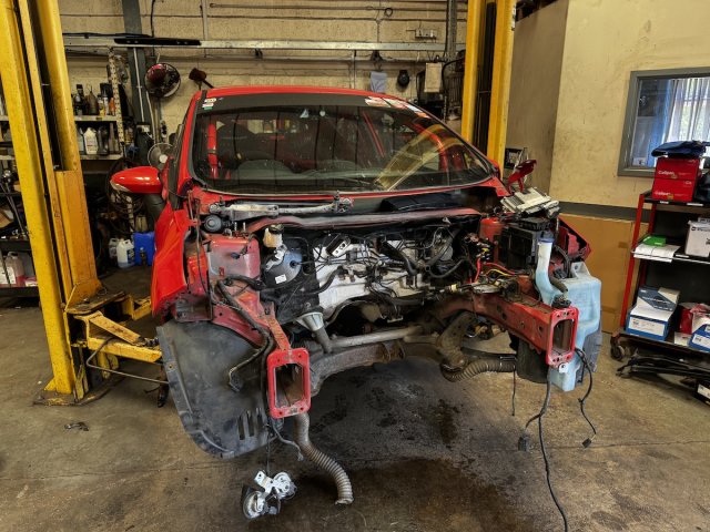

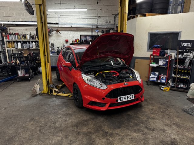

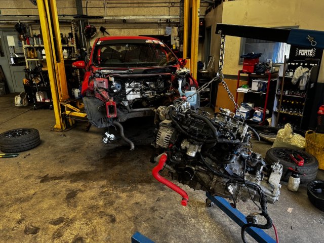

Afterwards drove to the garage to get the engine fitted. Took about 12 hours to get the old engine out, do the timing belt and water pump and then get everything refitted. Haven't been for the maiden voyage yet, but should hopefully get it booked in with TRS at the end of the month to have it tuned for the S280.
The replacement engine was on its original belt but was at least in time. The engine came with a new FoMoCo timing bet kit so swapped it over while the engine was out.
Back together and running by midnight!
