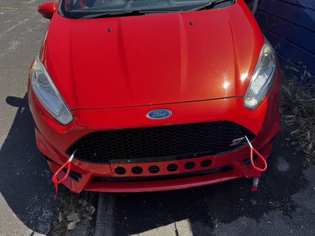

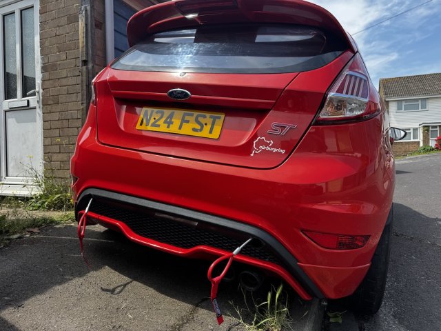

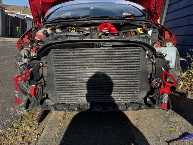

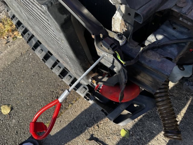

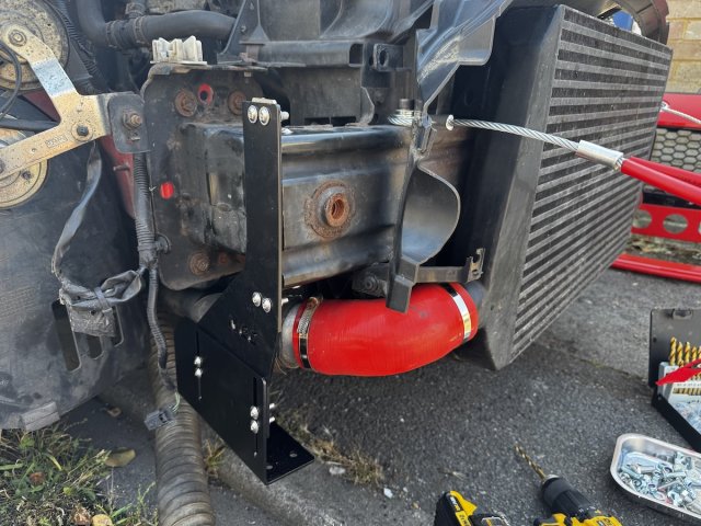

First up was to install wire tow loops - the MSUK rule book says that 1 front and 1 rear is required, but 2 at each end is preferred. I wanted to preserve the fixed front tow hook so I have them coming out of the grille. I used an M10 12.9 bolt with a thick washer on top and bolted them into the crash bars with nylock nuts. While I had the bumper off, I also installed the MGC splitter brackets. Still need to pick up some plywood to make the splitter.

Do those flop around at speed, or under cornering g forces, and knock against the body/grille?
I haven’t driven it yet but I suspect they will. You can tie them back but they must be quickly detachable by a marshal, so need to think of a solution. Velcro straps were my first though.
