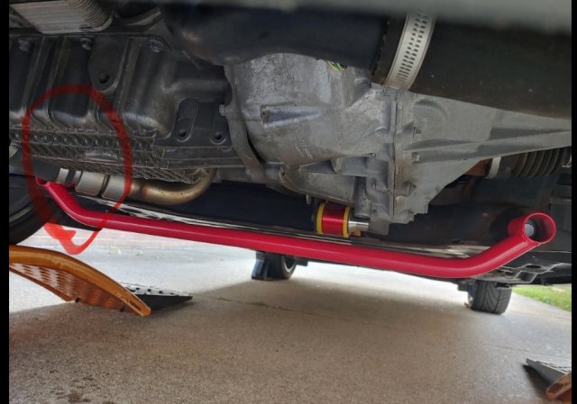

I was trying to figure out why the front end seemed loose even after a front end alignment. The car felt unstable as if a strong wind was pushing the car. It turns out the lower bolt that holds the Whoosh trac bar in place has broken off and not working any more. There is definite play in the lower control arm which is probably what I was feeling.
This repair seems to be rather complicated for a backyard mechanic. Does it have to be done at the dealer or could a place like Pep-Boys handle it?

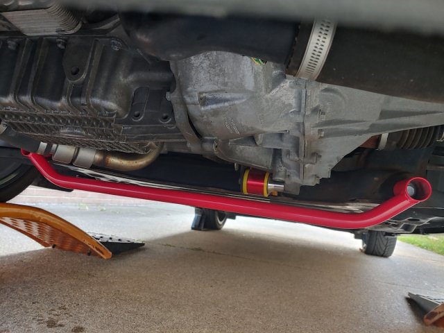

That is the photo right after it was put on. The bolt on the passenger side is the one no longer working.
